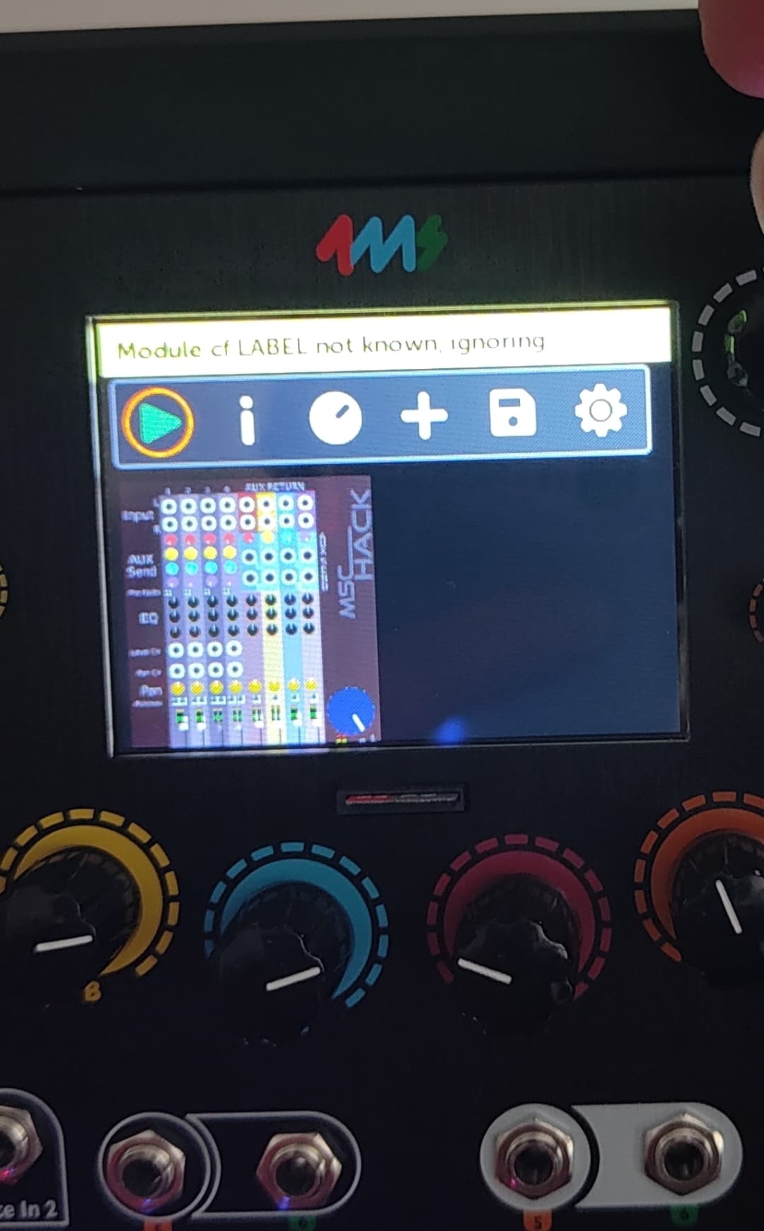

I discovered the MIX 4 Channel by mscHack. It’s exactly what I’m looking for.
On VCV it works but once in the MM and cables connected it does not work at all.
I started from simpler: a sound in input 1 and output master right left.
Can anyone test or tell me if the module works for you?
I may have missed something, but this is the 1st time a module doesn’t work like this in MM…
Thanks you

I made a simpler patch. Same
OL Table de Mix 2.yml (4.7 KB)
Module cf LABEL not known, ignoring
Will investigate, thanks for reporting
@ter1430
That’s a weird bug. I also noticed that there’s a whole slew of really small LED buttons that the creator configured in a strange way, so they don’t show up as a toggleable parameter on the MetaModule. I don’t have time to fix this today, but just leaving a note (mute, solo buttons aren’t controllable for mschack modules etc.)
I fixed the sound issue though, the EQ was the culprit, certain values weren’t updating. Let me know if this one works for you. Release Release: v2.0.1 · Ericxgao/metamodule-mschack · GitHub

I couldn’t wait to try it out. It works. Thank you
@ etcetc
Pre-fader buttons are also inactive. If it’s complicated, I’ll wait as long as it takes.
On VCV, no problem. On MM, these buttons are not selectable/adjustable.
a possible workaround for getting a mute functionality is to combine the mix4 with the ASAF8 - there’s a cv in for gate on the asaf8.. so you just send your signals into it, and then from it, into the mix 4
there’s no easy workaround that i can think of for pre-fader
