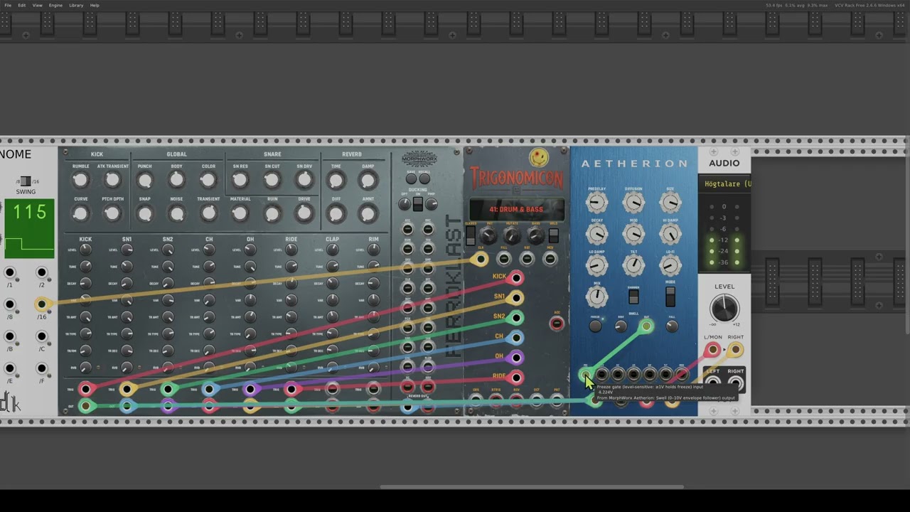

(i forgot to turn off HDR so the colors are garbage)

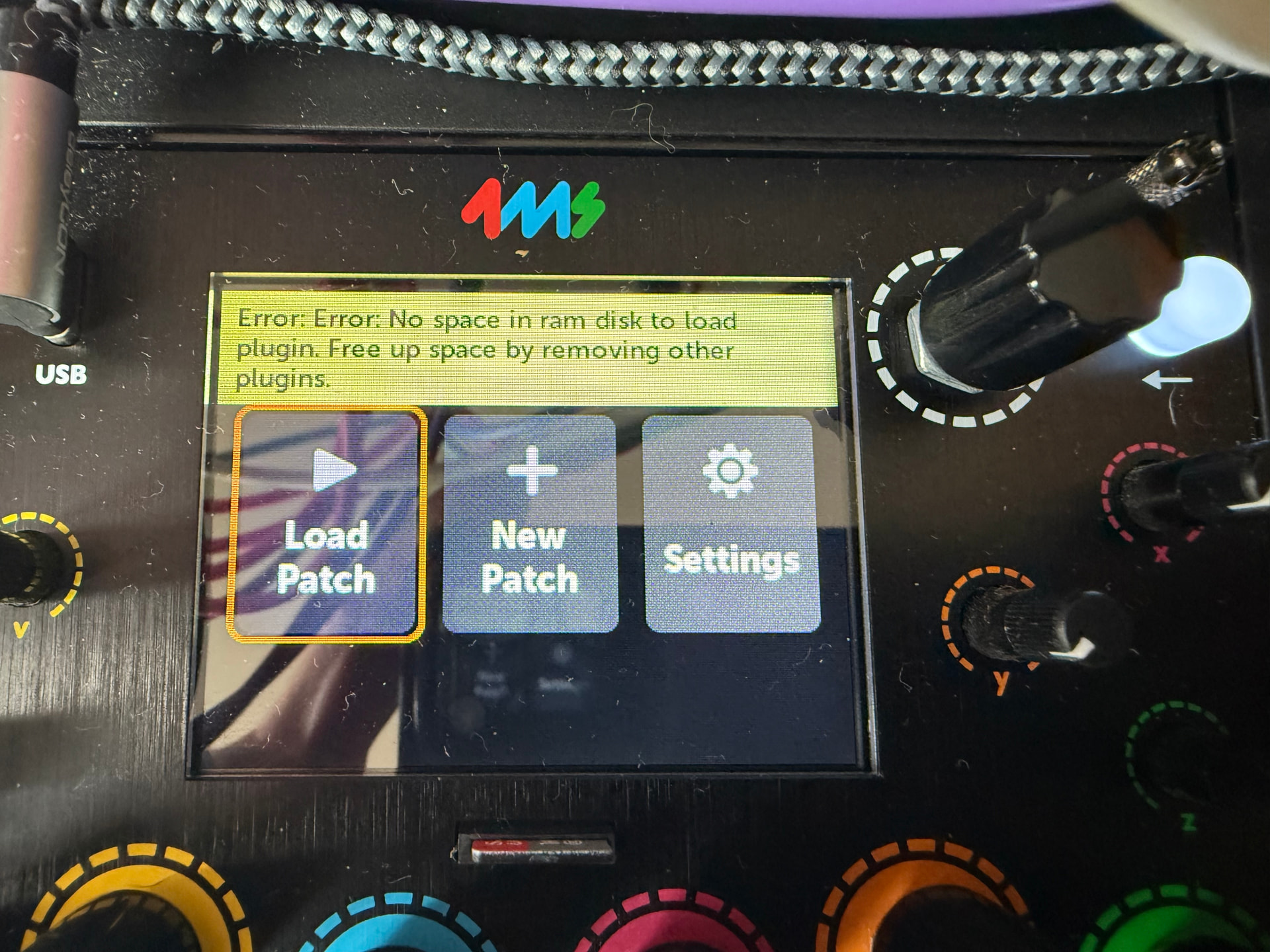

Hi @vurt
I downloaded FW 2.1.17 and when I boot the Meta at the end of the plugin loading, I get this message (capture) and my startup patch misses a Vult Freak filter.
When I deleted your “MorphWorx-v2.1.3.mmplugin” of the SD card the Meta boots fine (no error message) and my startup patch contains all the modules.
Can you have a shot on the new FW to confirm that your plugins conflict with the new FW? :folded_hands:
Same observation here on last 2 firmware drops. I think Dan adjusted memory on the last build and I was expecting it to work but it did not.

And with the new Poly FW it loads for me now
