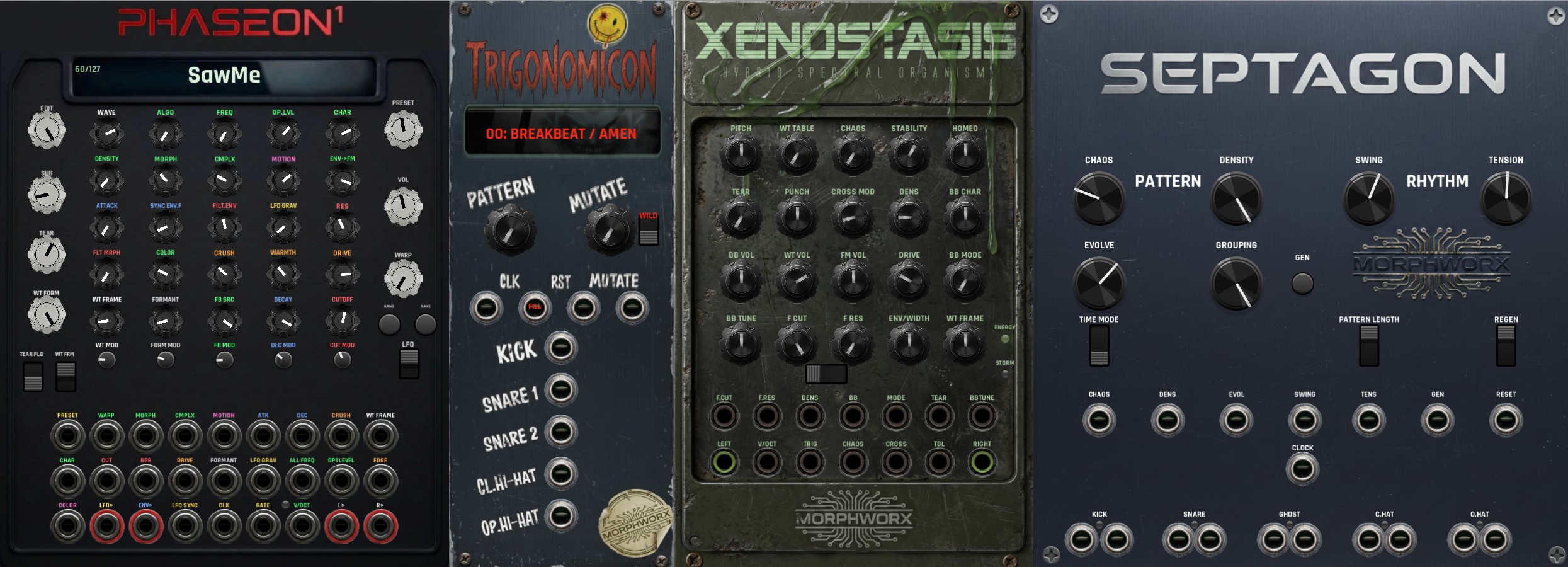

these are intense/awesome! so far really enjoying the noise/drones after hitting random on xenostastis/phaseon1! haven’t tried yet on mm but will hopefully find some time to explore there later
also xenostastis some of the more intense gui ive ever seen for vcv ;]

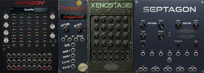

Cool, I gave it a go on the MetaModule. The modules seemed to work, and passed CPU tests.
Phaseon1 was in the 50%-ish range, Trigonomicon was in the 40% 4% range, and the others were under 20%.
Pretty fun and wild!
A few issues:
  • The phaseon files have to be on the sd card, it doesn’t work if they’re on the USB drive. This probably would be easy to be changed to allow them to be found anywhere. You can use the API call Patch::get_volume() ( metamodule-plugin-sdk/docs/system-api.md at main · 4ms/metamodule-plugin-sdk · GitHub ) to figure out where the patch is located, and then search there first, falling back onto the other drives if that fails.
  • I couldn’t tell if loading a new wave table in the Phaseon was doing anything or not? Maybe have a notification pop-up to indicate an error (or success?): metamodule-plugin-sdk/docs/system-api.md at main · 4ms/metamodule-plugin-sdk · GitHub
  • When viewed on the MetaModule, the knobs in the Phaseon and Xeno show up in a random order. It’d be easier if they were in row→column order (or column→row). To change this, you’ll need to re-order the enum ParamId values. Unfortunately that will mean existing patches will have their knob mappings scrambled.
  • A few times when patching a cable I got a big CPU spike. You can probably have your agent check over the code to verify there are no code paths that cause a memory allocation or de-allocation in the Module::process() function (or any functions that process() calls, of course). The most common mistake I see is creating, deleting, or appending to a std::string in the audio loop.
  • Overall they look good on the MM screen, with just a few tweaks here and there they’ll really shine: The text display for Trig seems to be offset downward so that it’s just barely outside the black box, and the red on textured grey/black is hard to see. Some of the jack spacing and knob sizes are off, and the fonts could grow a little bit to be more legible (to people who are gifted with sharp eyesight at least!) I haven’t played with graphics generation agents but I would hope it can target a given resolution and color depth (16-bit RGB565) rather than converting an SVG down to low-res PNG?
Anyways very fun and cool.
I don’t know if you have plans to release more than the windows vcv plugin, but these CI scripts should be able to handle building the MM plugin and all four VCV plugins:
Thank you Dann! Super helpful and I will let the agent fix these issues.
Trigonomicon should not take 40%, i just tested, fully patched + clocked: 10%. This was 32KHz though. So that is very weird if it really took 40% for you.
Phaseon1, yes 50% is 100% correct, its what i get as well.
Sorry, my mistake! I got 4% for the Trigonomicon (plus patch overhead is around 10% for a single-module patch)

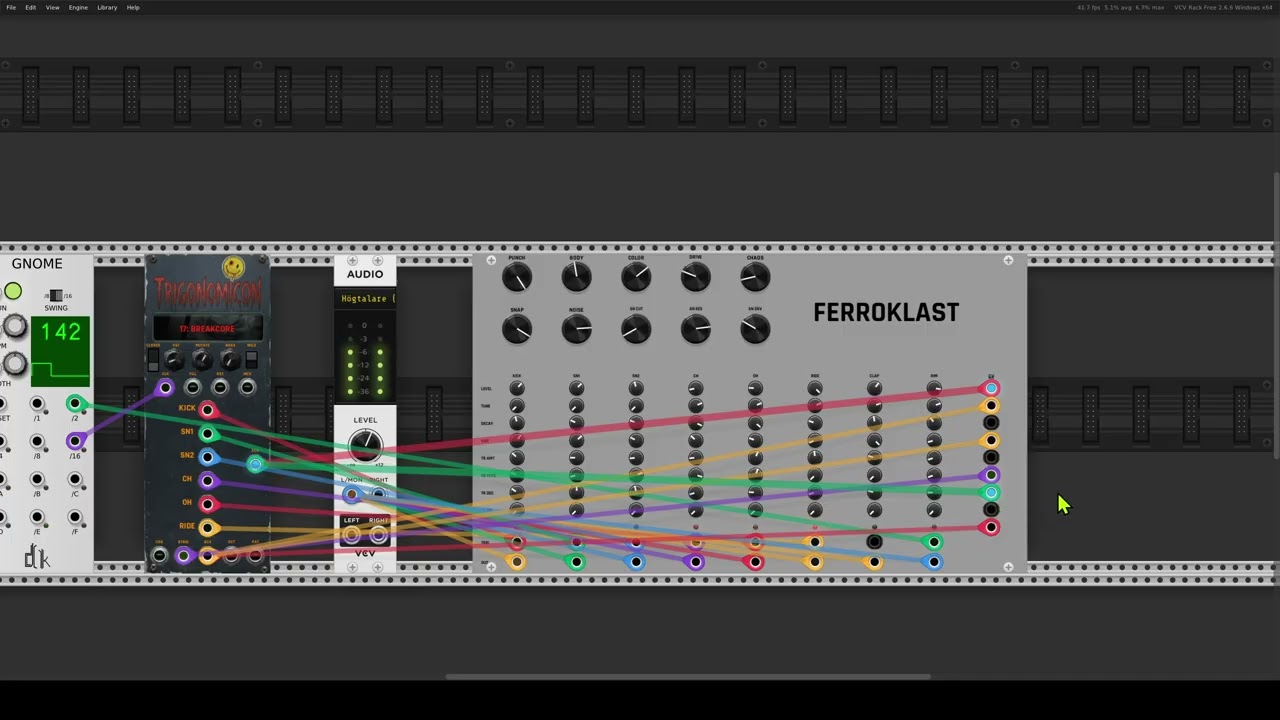

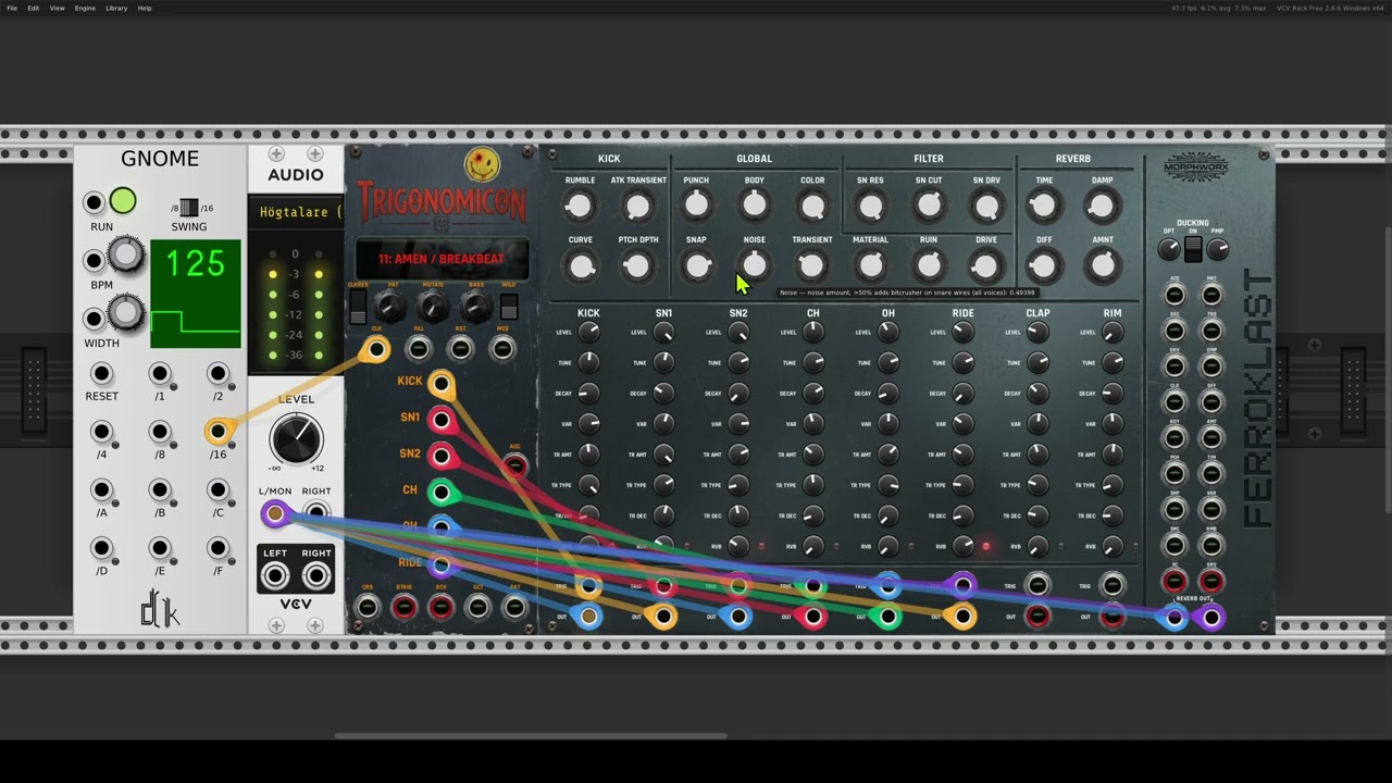

I made another drum module, 8 voice analog 909-style.
This one is currently not aimed for metamodule though, but i could perhaps do a stripped down version.
Nearing a final version of FERROKLAST for VCV Rack, tons of changes. Rumble for kick, sidechain (internal, external), reverb. 808 + 909-like snare (+ anything in-between). What inspired me the most for the kick was Bohm from Ohmforce, which might be my favorite kick drum.
The Kick alone has 20 different controls, so almost endless variety is possible.
Will be interesting to see what can be done with a MM version haha, this module was not made with it in mind so i am curious what can be done and if it can have acceptable performance. I might remove reverb and a few other things.

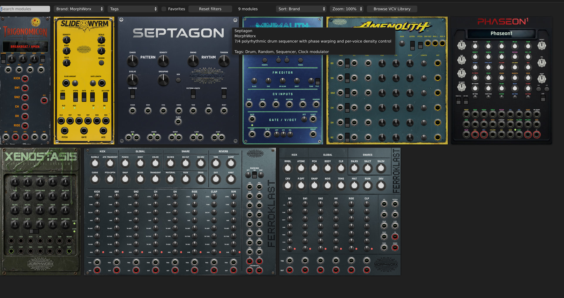

Release MorphWorx v2.1.0 · vurt72/MorphWorx
released for PC and Mac (ARM). Let me know if you run into issues or have suggestions.
It currently contains these modules:
Trigonomicon: Generative drum trigger sequencer for IDM, breakbeat, amen, and drill-inspired rhythms with mutation and probability-driven variation.
SlideWyrm: TB-303-inspired acid sequencer that generates pitch, gate, slide, and accent patterns.
Septagon: 7/4 polyrhythmic drum sequencer with phase-warped motion and independent density control per voice.
Minimalith: Compact PreenFM2-derived FM synth voice with patch loading and CV-driven modulation.
Amenolith: Multi-kit drum sampler with layered hits, roll behavior, tuning and length shaping, and individual outputs.
Phaseon1: Performance-focused 4-operator phase modulation synth with user wavetables, formant shaping, and expressive macro control.
Xenostasis: Self-evolving drone instrument that blends wavetable, bytebeat, and internal feedback into autonomous textures.
FerroKlast: Six-voice FM / Analog style (808/909 inspired) percussion synth for kicks, snares, metallic hats, and unstable industrial percussion.
FerroKlast MM: Streamlined MetaModule edition with a reduced voice set and tighter control surface.

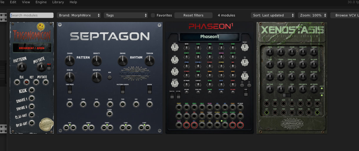

i just installed the MorphWorx-2.1.0-win-x64.vcvplugin and these are the only ones showing up in vcv is that correct?
no, it should be 9 modules. tested. I cleaned out morphworx from plugins entirely, then pasted the MorphWorx-2.1.0-win-x64 file in the plugins folder, restarted rack 2, all 9 modules shows up for me.
Updated it (MM plugin) again. Minimalith had an error where it didn’t load the USR files (user waveforms) for the included bank.
that seemed to do the trick, ty!!
not sure why vcv can’t clean it up for us.. (i’m sure there’s a good reason)
