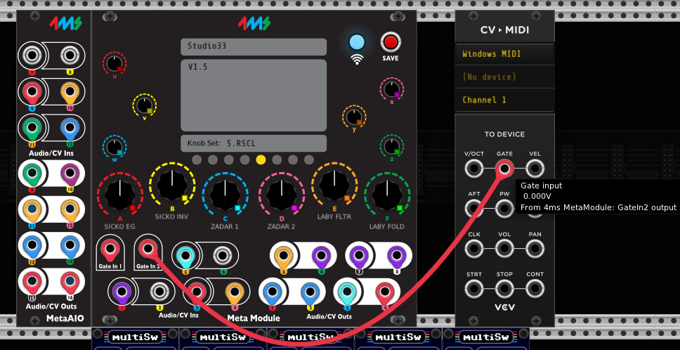

I’m having the same issue. I’m using firmware v2.1.14 and the plugins from 03/26/2020. The module cannot be loaded via VCV. In MM itself, I can select and use the module. However, I’m not receiving any gate information (source: Gate2 input). If I use the clock input (as well as the Start and Stop inputs) as an output instead, signals are sent to the MPC One.

Thanks for the quick fix. I installed the update, started a new patch, and only used the CV > MIDI module there. I can see “Start,” “Stop,” and “Continue” displayed on the screen, but I’m not receiving any signals at all. My setup hasn’t changed since then.
