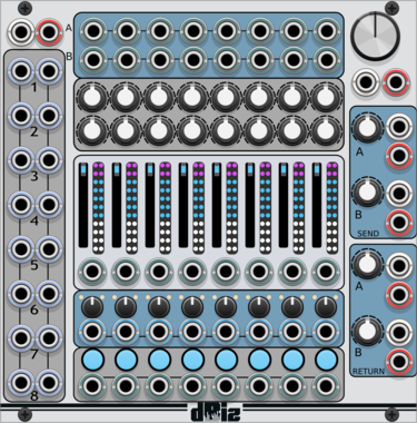

Haven’t tried it on MM, but dBiz PerfMixer fits the bill.
Dbiz has very nice modules but unfortunately there is no documentation about them…
This one looks pretty self-explanatory, except I can’t figure out the stereo jacks at the top left.
Yeah - I was puzzled by those as well. I assume they are for chaining mixers together. After mixing everything and then applying the Master volume control, then that result is summed with the upper left inputs. I think it would be nicer if those inputs were also attenuated by the Master.
