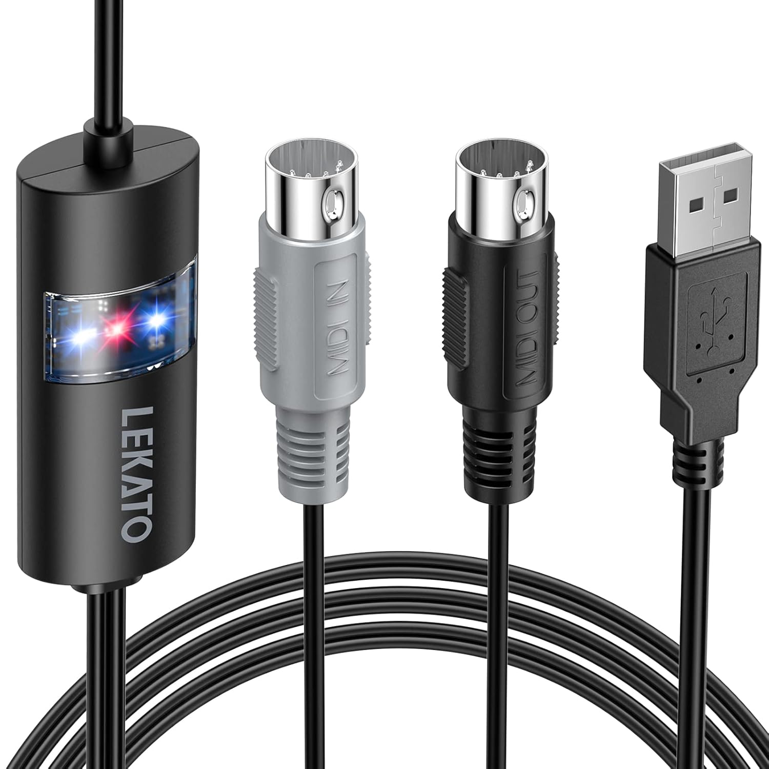

Try something like this with the DN:
£15 ish. If it doesn’t work Amazon will probably refund you. There are lots of equivalent products on the Amazon store so just get whatever is similar and available on your local store.

Thanks - ordered this and hopefully will resolve the problems. Looking for some overlap between DN!!'s advanced chord seq’ing and it’s midi, but might be disappointed - if midi tracks can’t be layered with it’s synth tracks it might not be so wonderful.
