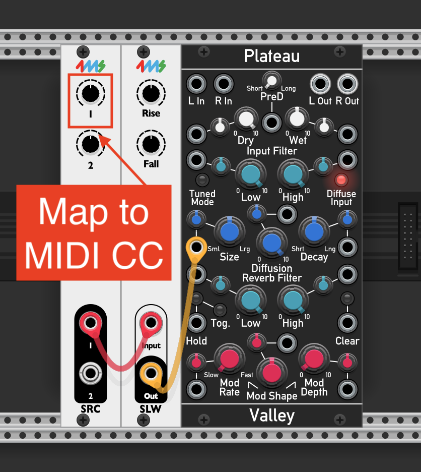

I notice crackles when I move my Midi controllers on Plateau : Size knob
I tried both with 16N faderport and LaunchcontrolXL and same crackles
When I map to a Meta knob I don’t have those crackles.
I have those crackles when I plug (pannel cable) an Lfo to the Size jack.
I’m on firmware V2.0.5

Hi Guitoo - MIDI only has 128 discrete values and does not interpolate between those steps, you’re most likely hearing the plugin “snap” or “jump” to those values which could cause audible glitches or clicks. On a parameter like “size” which is interrelated with decay time in the space, that’s even more noticeable as it rings out.
Why don’t you try mapping the CC to an offset with slew and let me know if that solves your issue. Adjust the rise and fall time to taste (short values are best). Let me know how it goes

Hi Ross,
Thank you so much for your explanation, it makes sense!
And thanks for your solution that’s a great way to counter that, I’ll try it asap

Hi Ross,
A quick message to tell you that it works fine thanks !
