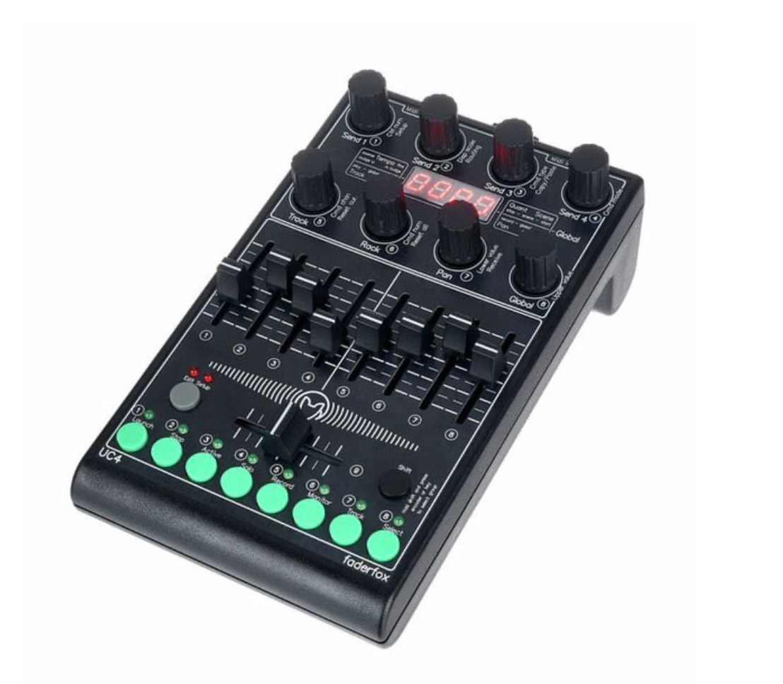

I think it’s a great idea to assign fixed MIDI values to all knobs in the MetaModule. Right now, whenever I finish a patch, I always have to remap all the knobs again.

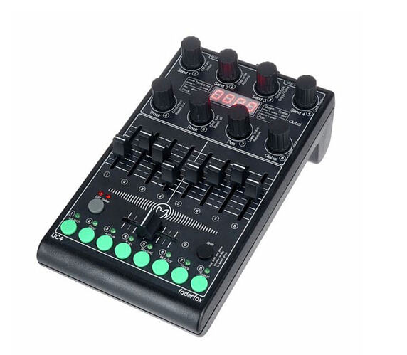

I’m using the Faderfox UC-4, and it works perfectly in combination with the MetaModule knobs.

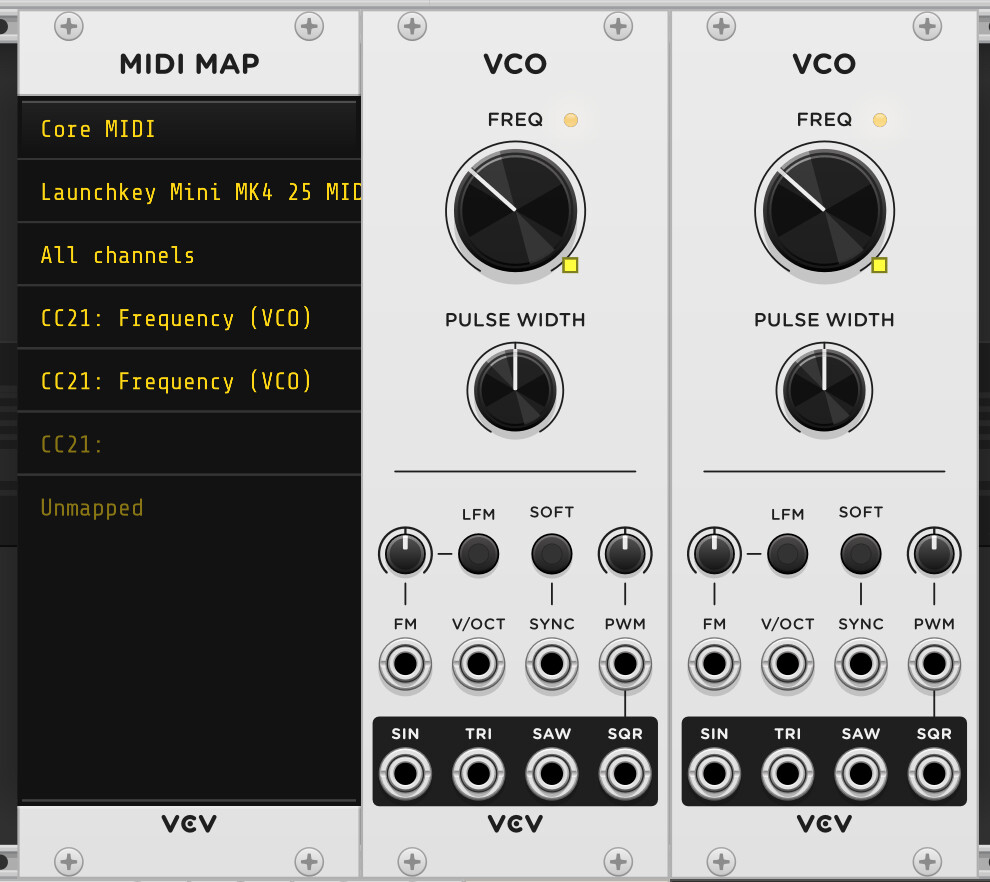

So did you do the midi mapping on the metamodule or in vcv? because in vcv I can only map one knobset. When I try to MIDI map a second knobset, it removes the mappings from the first knobset.

I added the mappings manually, just a copy/paste in the .yml file and then changed the IDs from the physical knobs to the MIDI CCs. I manually did what I’m proposing we have the firmware (or VCV Rack hub module) do automatically. It’s not easy to do this from within VCV Rack from the user’s point of view, but it’s trivial to do it from within the firmware or hub module code.
