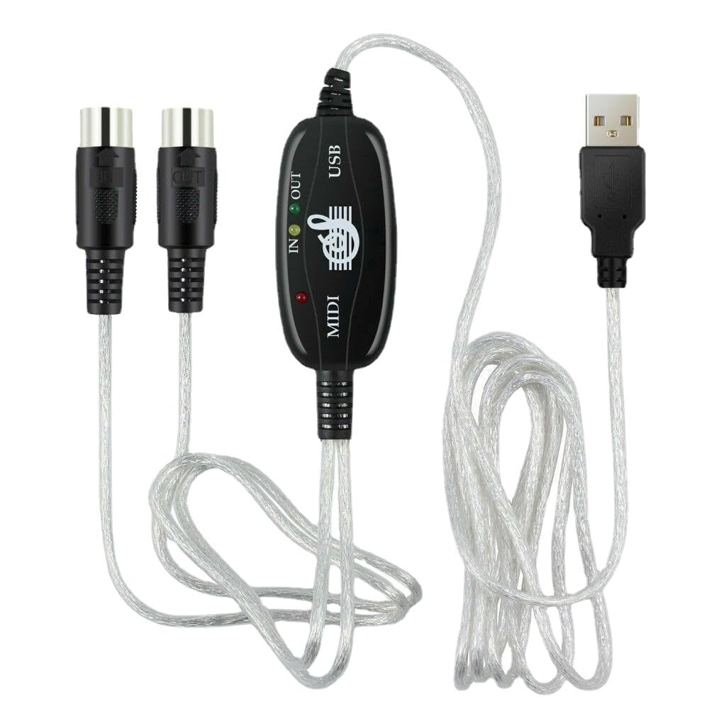

Thanks for the info. I have been able to get the Ableton Move working with the VCV Rack using a USB to MIDI interface connected to the MIDI jacks on my audio interface.
Next, I will try using a few USB to MIDI cables with DIN couplers to see if that will work.

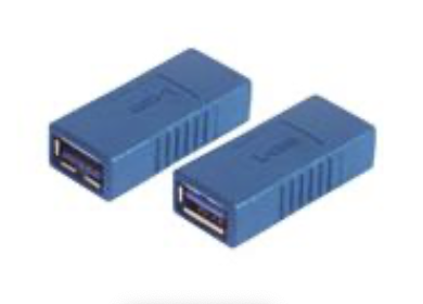

mine was much simpler, something like this
you just plug in two normal usb-a cables and works a treat.
the above is not mine exactly, as I got mine from a local Spanish website years ago, and I don’t think they sell them any more.
but they are all very similar, you can make them (diy) pretty easily using teensy or similar.
I checked around and have not found any dongle solution like the one in your picture. As a result, I will try the dual MIDI-USB cable method and see if I can get that working.
If not, I will look at the Teensy solutions.
