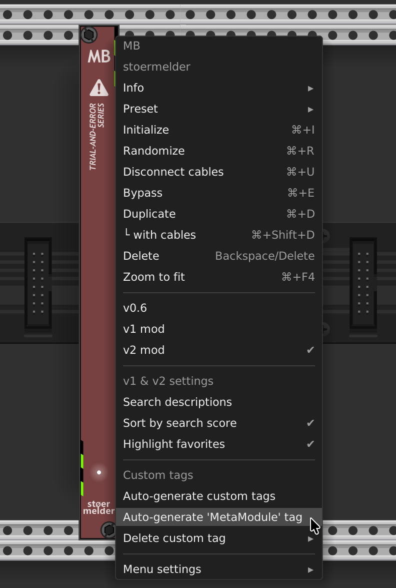

I’ve added a “v2 mod” the my MB module, which replaces the default module browser with a modified one. This module has been around for quite some time, but it only had the very old “v0.6” browser and a modded one from “v1”.
The modded version from v2 has custom tags and I implemented auto-tagging using the YAML file, so you can attach a custom tag “MetaModule” super easy to all supported modules.
This is all in development, but you can download the latest development build (or build it yourself), if you want.

For some reason I loose the favourites tag when using the MB plug in. Can we marry the 2 some how ?
This is because MB had favorites in VCV Rack v1, but v1 had no built-in function for it. I’ve just added an option which lets you select if you want to handle MB its own favorites or use VCV Rack’s function for this.
Just flagging for everybody that this is now part of the released version of stoermelder’s PackOne plugin, so you can install it direct from the VCV library.
