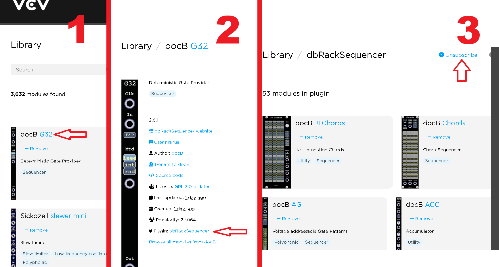

@tenofswords ah ok! Is there an easy way to add all the possible meta modules to my library or do I need to click + on each one one by one?
you have to ‘subscribe’ to a plugin brand. that way also any time they come out with a new module in their brand, it automatically is added to your account. i actually had to explain this to a coworker who im tutoring on vcv so i made this screenshot for them. hope it helps here:
