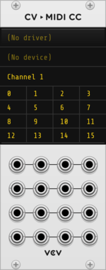

i believe dan mentioned at some point in some thread that the remaining rack core ones would be ported over.. this would be a useful one for ccs:
It sure would! I can’t wait until this happens!
Is there a change to have CV to Midi module managing V/oct, gate and sync? It should transform my MM in a dream multitool sequencer :slight_smile:
