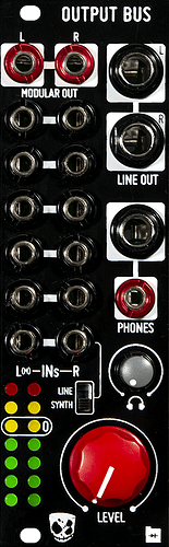

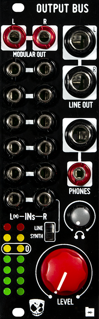

I use the Divkid (Befaco) Outpus Bus. OUTPUT BUS - Befaco
A great module to get line level up to Eurorack, Eurorack up to Line, add distortion to Eurorack level using the last set of inputs and has a very clean headphone output. Since the Meta Module autoruns, you can turn the knob all the way down which mutes the sound.

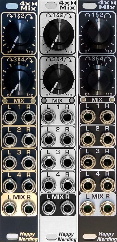

i use (and love) the happy nerding 4x st mix module, low cost small 4hp and allows you to mix multiple stereo outs from the mm (or sometimes my laptop, or ipad, or sp404) together w independent vol knobs which works good for stepping any input down to line/headphones level. for me this module will be most useful once we have samplers on the mm.
Happy Nerding makes good stuff I have one of their original VCOs. I like the Befaco because it has line out capabilities and line in as well for pedals. Plus Befaco was one of the first people who supported 4ms and the Meta Module porting thier plugins from VCV. I just bought two of their modules to help support them for their support of the community. :slight_smile:
