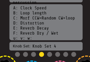

When I’m writing a patch description in VCV Rack I often want to break up the lines in the description. But the Return key doesn’t insert a line-break character so I have to hit the space bar until the cursor moves down to the next line.

the cursor does not respond to the enter- and navigation keys, making it tedious to write clearly organized notes.
i can’t even navigate up and down with the arrow keys as i am not able to fit all the knobs descriptions in one screen. also it’s impossible to reach and edit the text at the bottom.
