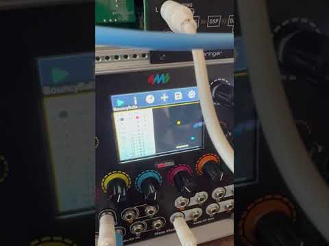

Looking nice!
Holy cow. I’m old enough to remember when virtual modules in the MM couldn’t do their own graphics.
Those are looking good! :+1:

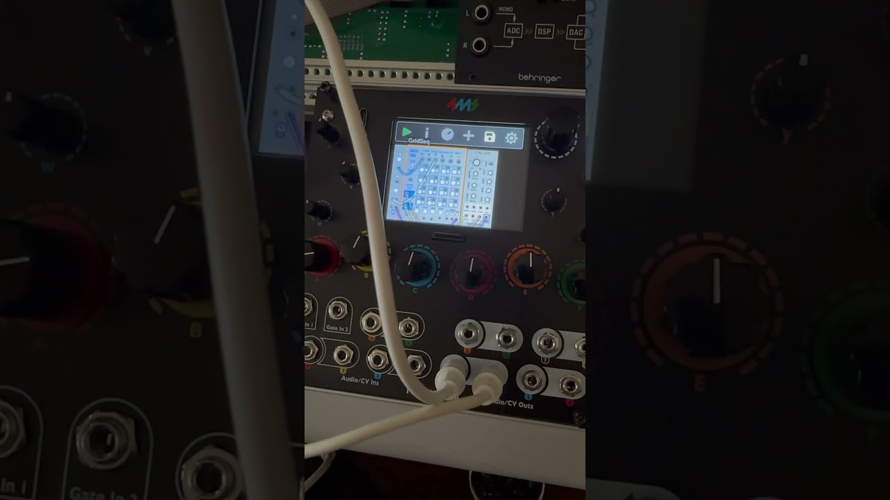

excellent! XYpad is working and looking great on mm so far (pairing well with 4ms slew)
