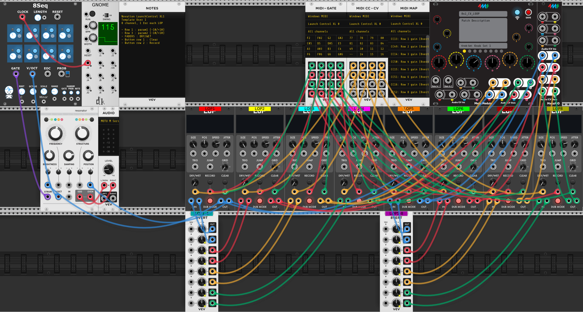

I did this patch that I’m using non-stop for several days now.
It’s 8 LöP modules, that I use to record 2 CV line (because LöP is stereo) with each Module from 8VERT modules (where knob are assigned to midi controller).
I’m using the Novation LaunchControl XL as midi controller (1 “channel” per LöP module).
For each “channel” of the Novation XL :
  • row 1 knob : assign to one 8VERT knob, to Record Param1 (Left Channel Input of LöP)
  • row 2 knob : unused
  • row 3 knob : assign to one 8VERT knob, to Record Param2 (Right Channel Input of LöP)
  • Fader : DRY/WET on the LöP
  • row 1 button : clear
  • row 2 button : record
So now I have 8x2 CV recording :slightly_smiling_face: . I hit “Record”, then record live 2 CV loop at the same time, hit “Record” again and that’s it. The fader “DRY/WET” is very usefull too. And I can “Clear” at any moment and do it again.
Wonderfull, thank you so much. So great to be able to records 8x2 independant loops !
I post my patch if it can be usefull for someone else. I think that I use the “standard” User 1 template on the Novation XL.
8x2_CV_LOOP_Full_VCV.vcv (4.5 KB)
8x2_CV_LOOP_For_MM.vcv (3.3 KB)
8x2_CV_LOOP.yml (15.8 KB)
