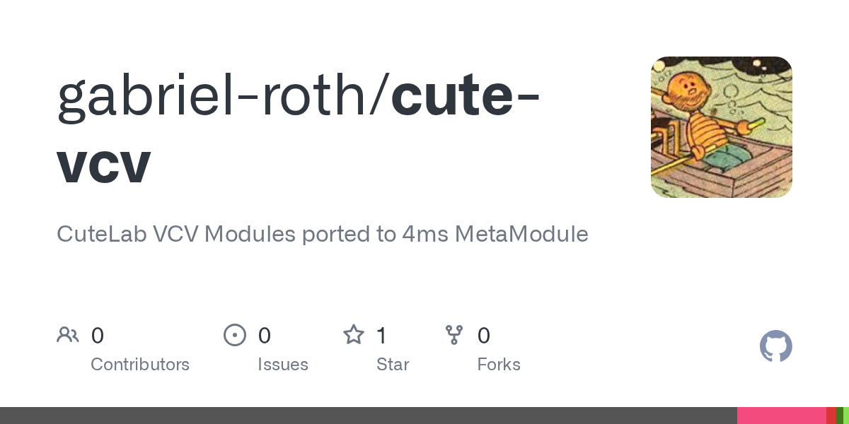

OK @danngreen, I think this is ready for release! The repo is at GitHub - gabriel-roth/cute-vcv: CuteLab VCV Modules ported to 4ms MetaModule.
There’s an issue where the panel displays a bit too wide on the MM (described here) — happy to fix that before release if you’ll give me some pointers. [EDIT: Fixed in latest version — I didn’t know about the image conversion script but I do now.]

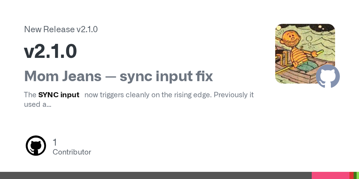

I took a look at this today and, with the help of Claude Code, I think I fixed it? Sync sounds a lot better now. Could you (and others) please download and test this version? CuteLab-v1.3-dev-1
@danngreen Mom Jeans has been updated for polyphony (and it sounds great with four voices imho).
@CosmoProductions This new release doesn’t include the sync fix that we were talking about in November … could you please try version 1.3-dev-1 and let me know if that matches your expectations? If so I’ll roll that fix into the polyphonic version.
Update: The sync fix sounds much better, I’m just gonna merge it in. @CosmoProductions, if it’s not what you’re looking for we can keep working on it.
Ok here’s the next version:
This one fixes the sync input, which is broken in the version in the VCV library. I added a VCV build if you want that fix in VCV, but bear in mind this isn’t the official version.
