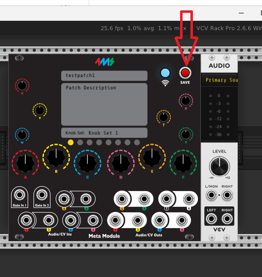

Hi, is there an inverse? A .vcv to .yml converter
“Hi, is there an inverse? A .vcv to .yml converter”
yes its the save button on the metamodule hub module:
