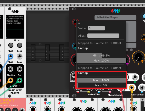

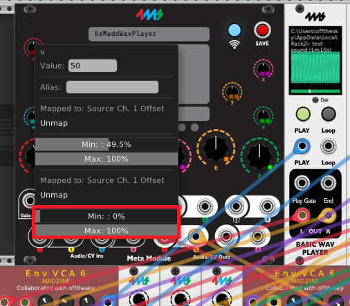

playing with this some more, noticing some discrepancies. in my original patch, the mapping offsets for certain knobs on the hub are set to 100%min, 0%max, but when converting the yml->vcv, those are getting flipped:
original:
converted:

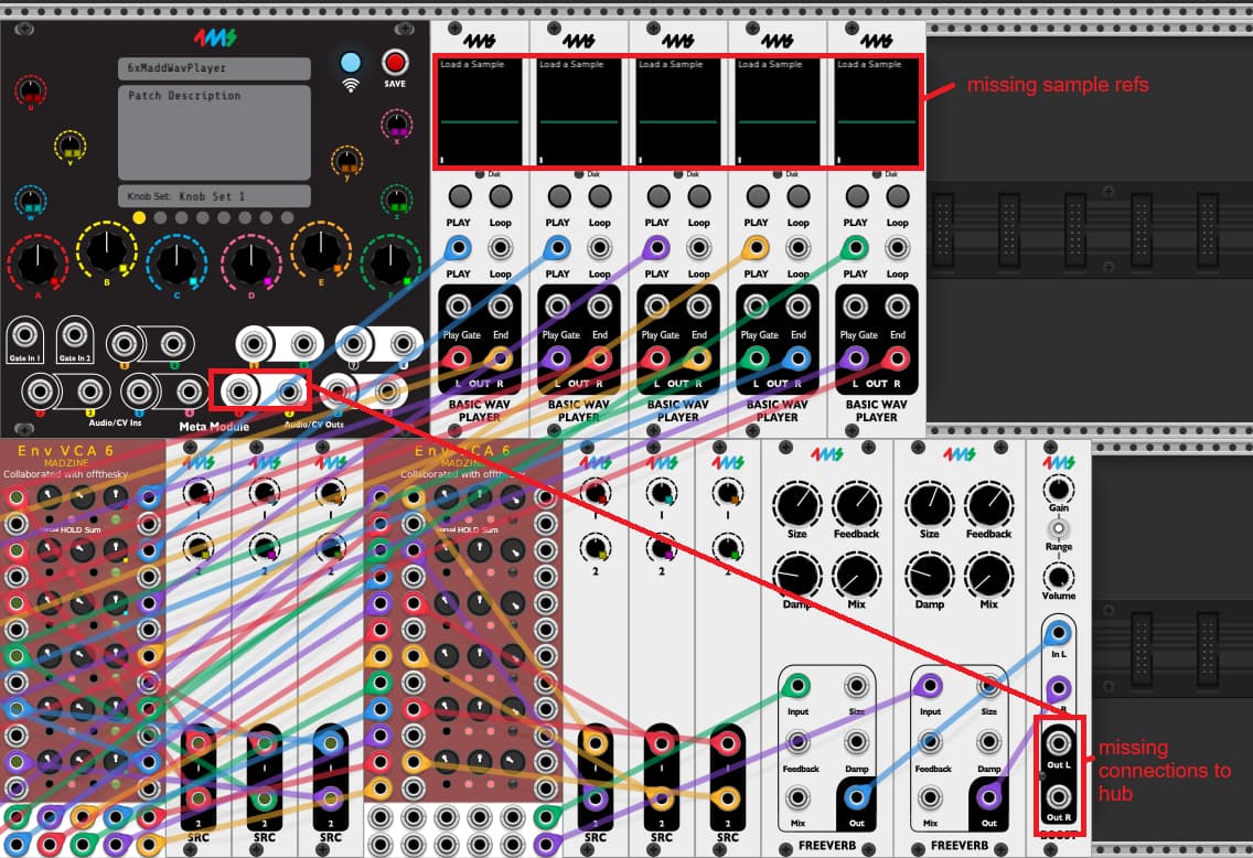

and maybe not such a huge deal, but the output wirings are getting lost to the hub, but also sample references (maybe this coincides with the point below about options):

Thanks for this report! Super helpful.
  • The issue with reversed knob mappings is fixed.
  • The issue with cables mapped to the Meta Hub is fixed.
  • The issue with missing sample paths is fixed.

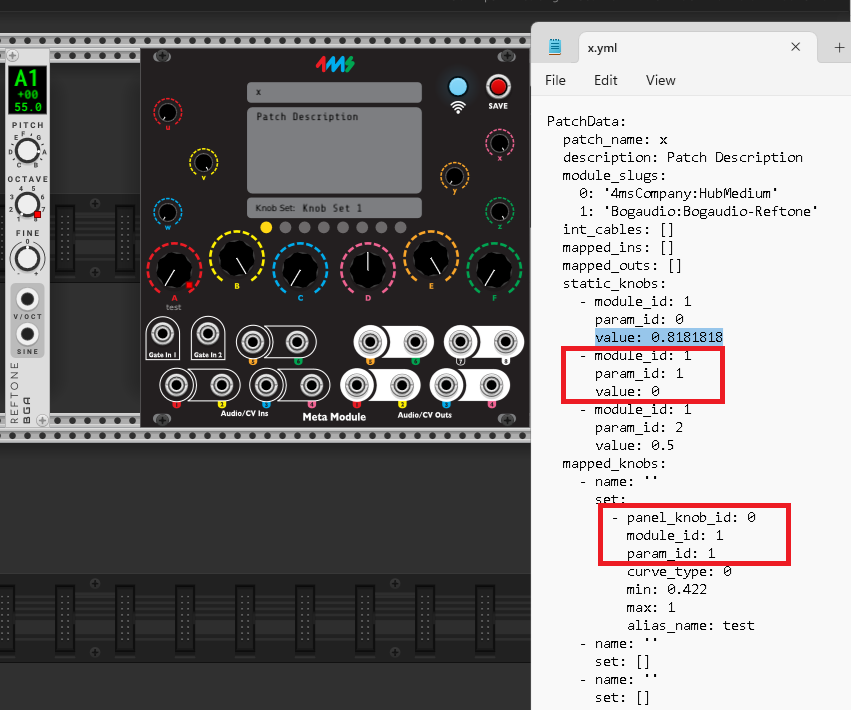

my guess is that the mm’s ‘default’ for the knob sets, is just using the modules params that are last set via the hub’s knobs before exporting to yml:
so maybe the only way to have the hub’s knobs set back from yml-vcv would be to read value of the params they’re mapped to and then set the hubs knobs according? i don’t know…

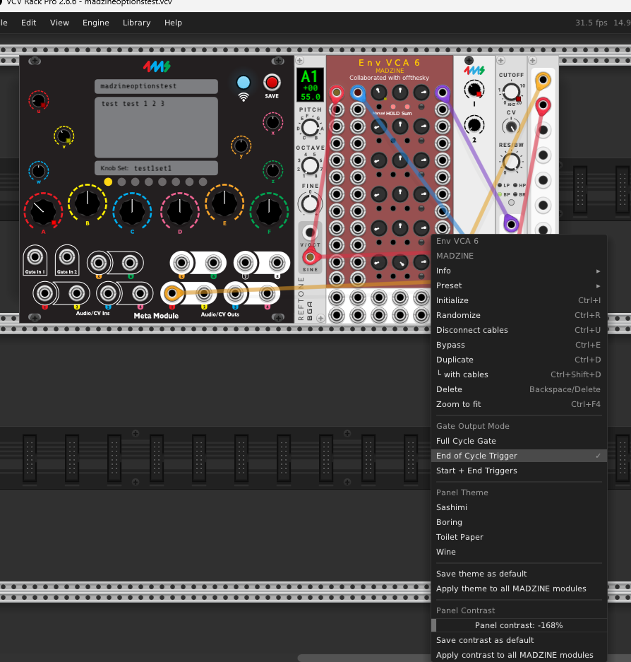

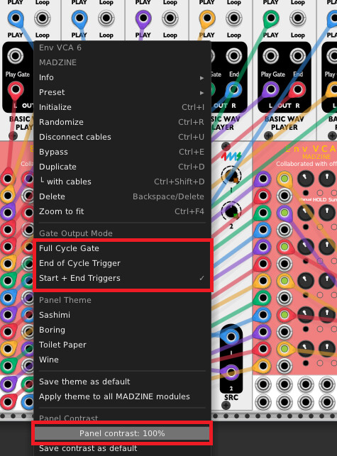

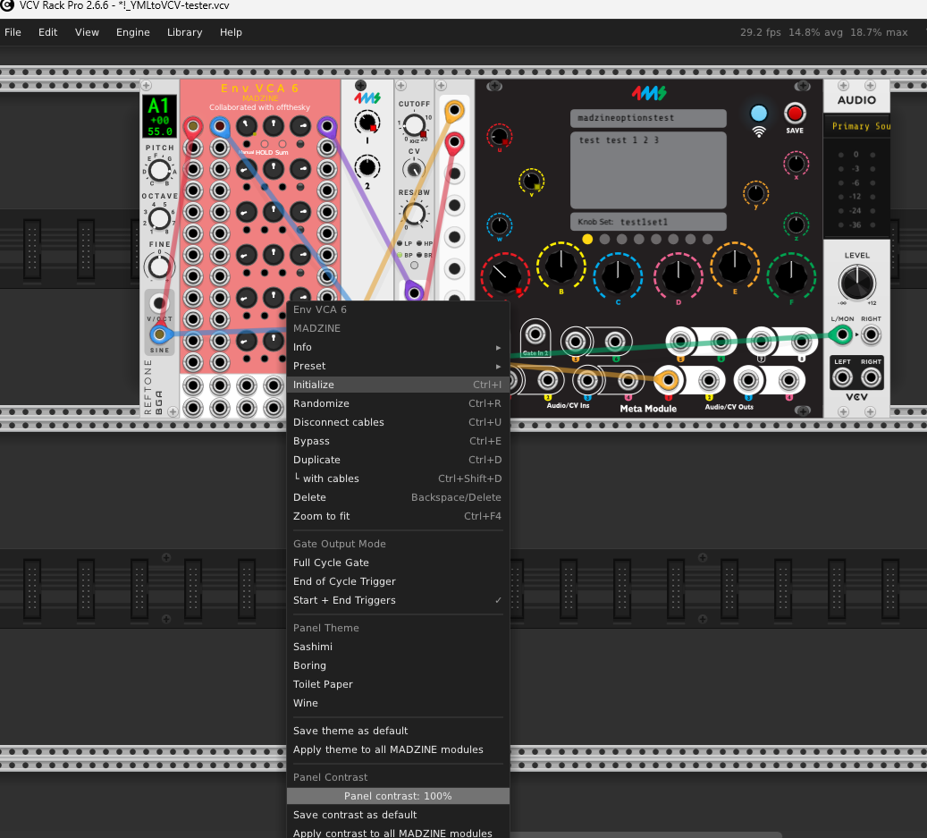

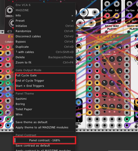

i’m trying this with the madzine env vca 6 module, and it still doesn’t seem to be catching the proper options (namely the gate output mode section):
original:
yml-vcv:
perhaps i’m not doing some right though :slight_smile:
Nope, you’re right, it’s a bug. Working on it!
