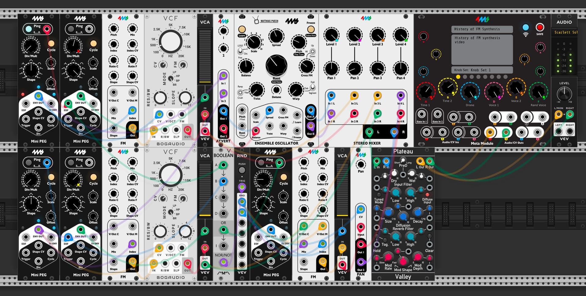

You can watch the video for this patch on YouTube here.
-There are two identical voices consisting of a 4ms FM running into Bogaudio notch filter
-Bogaudio notch filter is running into a VCA and then the main mixer
-An ensemble oscillator’s stereo outputs are going to the main mixer
-A third 4ms FM is running into a VCA and then a pan module before hitting the main mixer
-The main mixer is being fed into a plateau reverb.
-A mini PEG’s envelope is going to the index input of FM1 and 2 as well as their associated volumes.
-The EOC output is clocking a second PEG for each voice. For voice 1, the envelope output is controlling the spread of the ensemble oscillator. For voice 2, this envelope is controlling the balance of the ensemble oscillator. For both voices this CV is also controlling the cutoff of the notch filter.
-The EOF outputs from both mini PEG’s voices are combined together. This clock signal is pinging a third envelope as well as triggering a random voltage.
-The third envelope controls the volume of the third voice.
-The random voltage randomizes carrier, modulator, mix, and index on the third 4ms FM.

Hi, great patch, but I cannot run it on my 4ms meta module as it goes OL. The patch forces 48k/512. Any ideas why it is not working?
Thanks a lot!
Sorry about that, I saved it with the wrong sample rate. I replaced the YML on this post, let me know if you have any other issues. It should run fine at 32k.
That’s awesome, thanks a lot!
