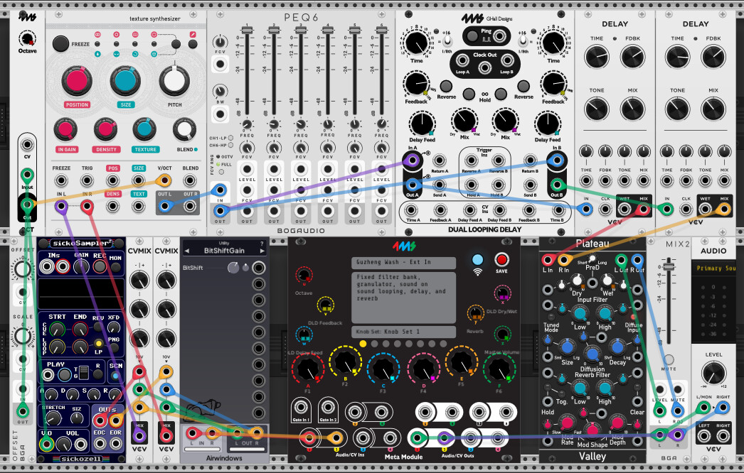

NOTE: FOR THIS PATCH TO WORK YOU MUST LOAD THE INCLUDED GUHZENG.WAV FILE ONTO YOUR SD CARD AND LOAD IT INTO THE SICKOSAMPLER. SAVE THE YML FILE AFTER LOADING SO THAT YOU DON’T HAVE TO RELOAD THE SAMPLE NEXT TIME YOU OPEN IT. YOU ALSO NEED TO PUSH THE PLAY BUTTON ON SICKOSAMPLER AFTER LOADING THE SAMPLE.
-Main audio outputs on ch. 1 and 2
-The Guhzeng sample is being played by the sickSampler
-SickoSampler is fed into the Texture Synthesizer for granular effects
-The Texture Synthesizer runs into a PEQ6 6 band fixed filter bank for spectral mixing.
-The PEQ6 is fed into a DLD for sound on sound looping
-The DLD is then fed into a stereo delay line, with the left and right channels set to different times.
-The output of the delays are fed into a plateau reverb
-The plateau reverb is then sent to an attenuator for final volume amount
-A 1v offset is fed into an octave module for controlling the pitch of the sample and the Texture Synthesizer. This is so that the pitch remains consistent with a doubling and halving of the base frequency.

altered a bit a running my guitar through it (just patched In1 on the mm input 1/2 on clouds). sounds great and is a lot of fun to play live into!

i used the airwindows bit shift gain module to boost mm inputs 1/2, and then the cvmix module in the fundamental plugin to mix the outputs of the bit shift gain that my guitar/keyboard ran through, and also the sampler (just the left out) into the cvmix, and then the cvmix out into the inputs of clouds.
i just did all that on the mm. ill upload the yml tomorrow

my external input mod:
Guzheng Wash - External Input.vcv (3.8 KB)
Guzheng Wash - Ext In.yml (17.3 KB)
