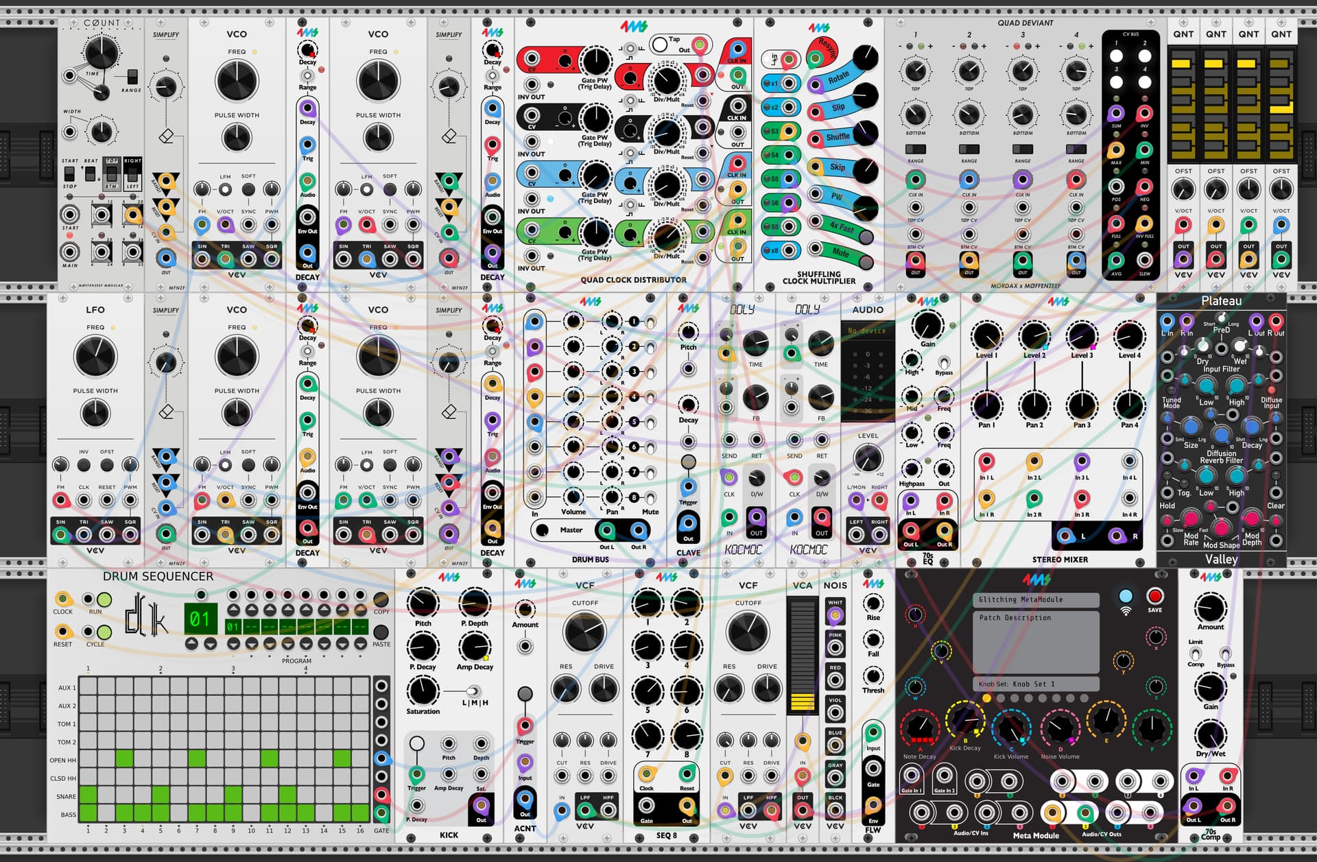

Glitching Patch
NOTE seeing as this patch was designed to deliberately run MetaModule at the brink of failure, you need to adjust the maximum override retries to 64. Go to settings > prefs > and scroll down until you see “Overrun retries.”
External Audio Routing:
Internal Audio Routing:
-4 identical synth voices consist of a triangle wave VCO fed into a Decay module.
-Each synth voice is ran into a Drum Bus
-A clave is also mixed into this Drum Bus
-The Drum Bus runs into a stereo delay line made from two KocMoc DDLY’s
-The Delays run into the 70s EQ for shaping the bus.
-The output of the bus is fed into a stereo mixer
-The stereo mixer is ran into a plate reverb.
-The entire mix is compressed with the 70s Comp before being sent to the main outs.
-A kick drum is ran into an Accent and then a lowpass to remove the click-ness.
-A white noise gen is ran into a highpass filter and then a VCA
-The rhythmic noise and kick drum are also sent to the main mixer
Internal Logic Routing:
-A master clock pulse from Count is divided with the quad clock distributor
-A /4 output is clocking the shuffling clock multiplier and also resetting it
-A /16 pulse is used as a reset for all Simplifys as well as both sequencers
-A x4 output is clocking the drum sequencer, all Simplifys, and both KocMoc DDLY’s
-Outputs from the SCM are sent to Quad Deviant as well as 4 Simplifys
-The Simplify modules trigger each synth voice
-Sequences from drum sequencer trigger the Clave, the Kick, and a 1/4 note accent for the kick
Internal CV Routing:
-The outputs from Quad Deviant are modulation all of the parameters on the SCM, the delay times, the 4 Simplifys and all of the decay times
-The Deviant voltages are also being quantized to be used as note data for all four voices
-An 8 step sequence is modulating the cutoff of the white noise’s highpass filter
-The same sequence is fed into a voltage follower with a medium release time to slew it a bit and then controls the volume of the same white noise source
MetaModule Knob Mapping:
A - Note decay
B - Kick decay
C - Kick volume
D - Noise volume
Glitching MetaModule.vcv (6.6 KB)
Glitching MetaModule.yml (46.7 KB)
