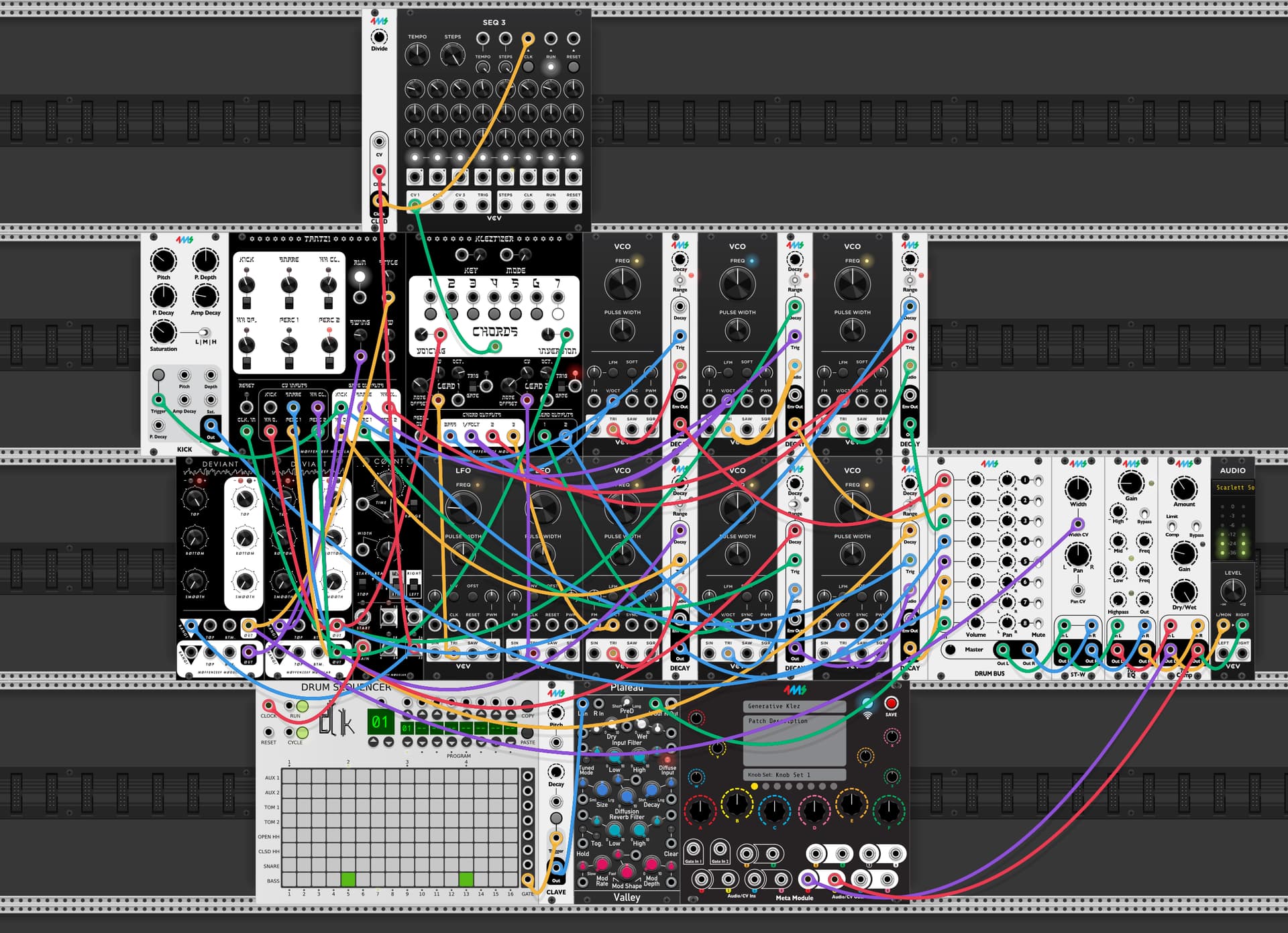

-Main audio outputs on channels 1 and 2.
-There are six identical synth voices that consist of a triangle wave VCO fed into a Decay module
-The 6 voice modules are fed into a drum bus
-A kick drum is fed into the drum bus
-A clave is fed into a reverb and then into the drum bus
-The drum bus is fed into the Stereo Width module
-Stereo width is fed into 70s EQ
-70s EQ is fed into 70s Comp
-70s Comp goes to the outputs
Internal Logic Path:
-The Count main output clocks Tantz! And a drum sequencer
-The /8 output from Count clocks a Deviant and is also fed into another clock divider that /8 again
-The divided clock drives a seq 3
-The outputs of Tantz! Are fed to all 6 decay envelopes
-Tantz! Kick output triggered a kick drum, as well as one of the deviants.
-The outputs from Deviant being clocked at /8 modulate all of the rhythms on Tantz! except the kick pattern
-The outputs from that same deviant also modulate Swing and Style on Tantz!
-The sequencer output selects specific chords on Tantz!
-Two separate triangle wave LFOs are fed into the Lead 1 and Lead 2 inputs on Tantz!
-All of the chord outputs, and both lead outputs for Tantz! Are fed to the 6 oscillators
-Deviant is modulating the master stereo width module

wow, such a fun patch!
I added some knobs, incase anyone want’s a bit more control, you can choose the chords, and set the key, scale, and get weird and wacky in the clav section with the reverb.
