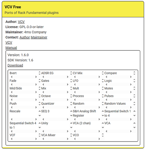

I’m running firmware v1.6.13 and the latest version (1.6.0) of Fundamental plugins are loaded, but I’m getting a not known message on loading a patch that includes the VCV delay.

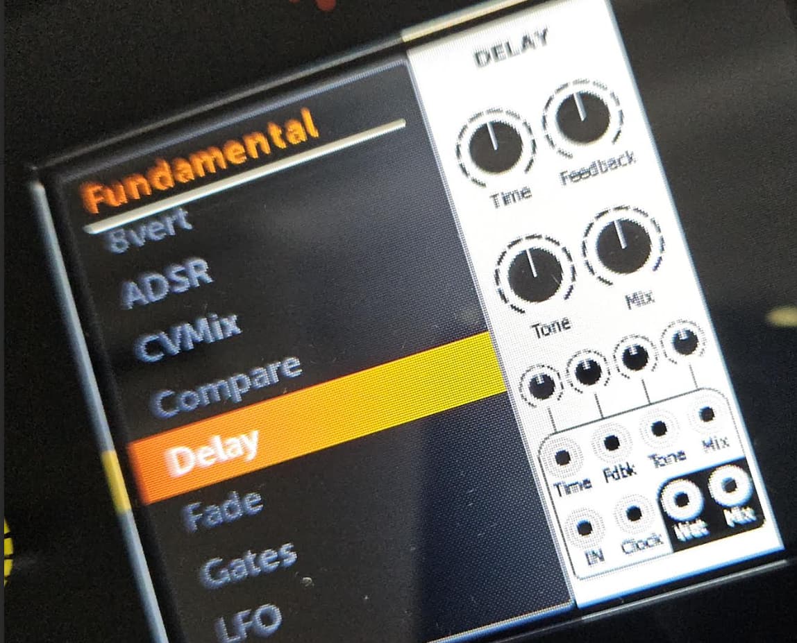

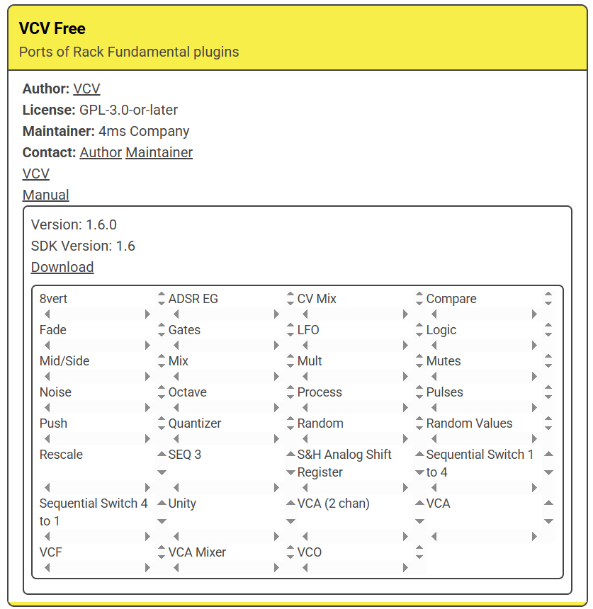

I am not seeing one so perhaps not all VCV racks are available? I’d check my MM later to confirm this.
Hmm, you’re right. I could have sworn that Delay was included before.
That’s good to know. I’ll update to v2 when it seems stable.
Right, IIRC, Delay depends on the libsamplerate library which we added in v2
