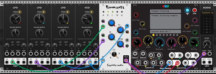

Formant Filtering Patch
Watch Formant Filtering on YouTube
-Main audio output on channels 1 and 2
-A sawtooth wave VCO is fed into Formants
-3 LFOs modulate Vowel, filter cutoff, and resonance of Formants
Metamodule Knob Mapping:
A - Vowel
B - Cutoff
C - Resonance
D - Brightness
E - Model
F - VCO frequency
U - LFO 1 frequency
V - LFO 2 frequency
W - LFO 3 frequency
X - LFO 1 depth
Y - LFO 2 depth
Z - LFO 3 depth
