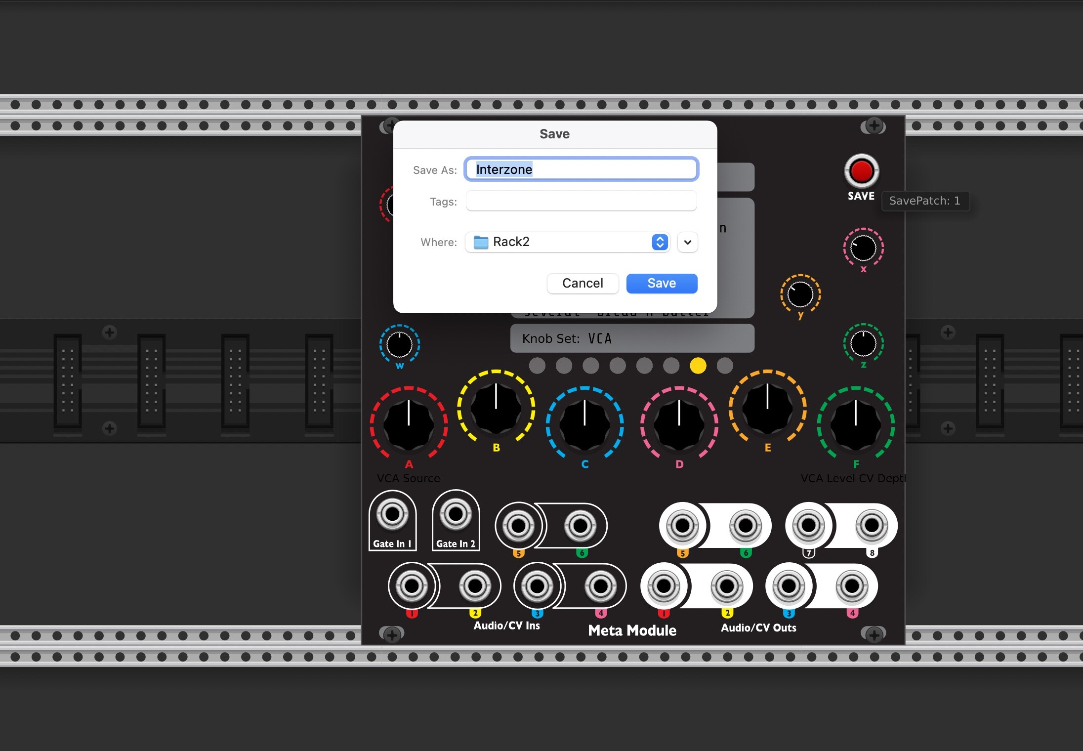

You can export it to wherever you like.

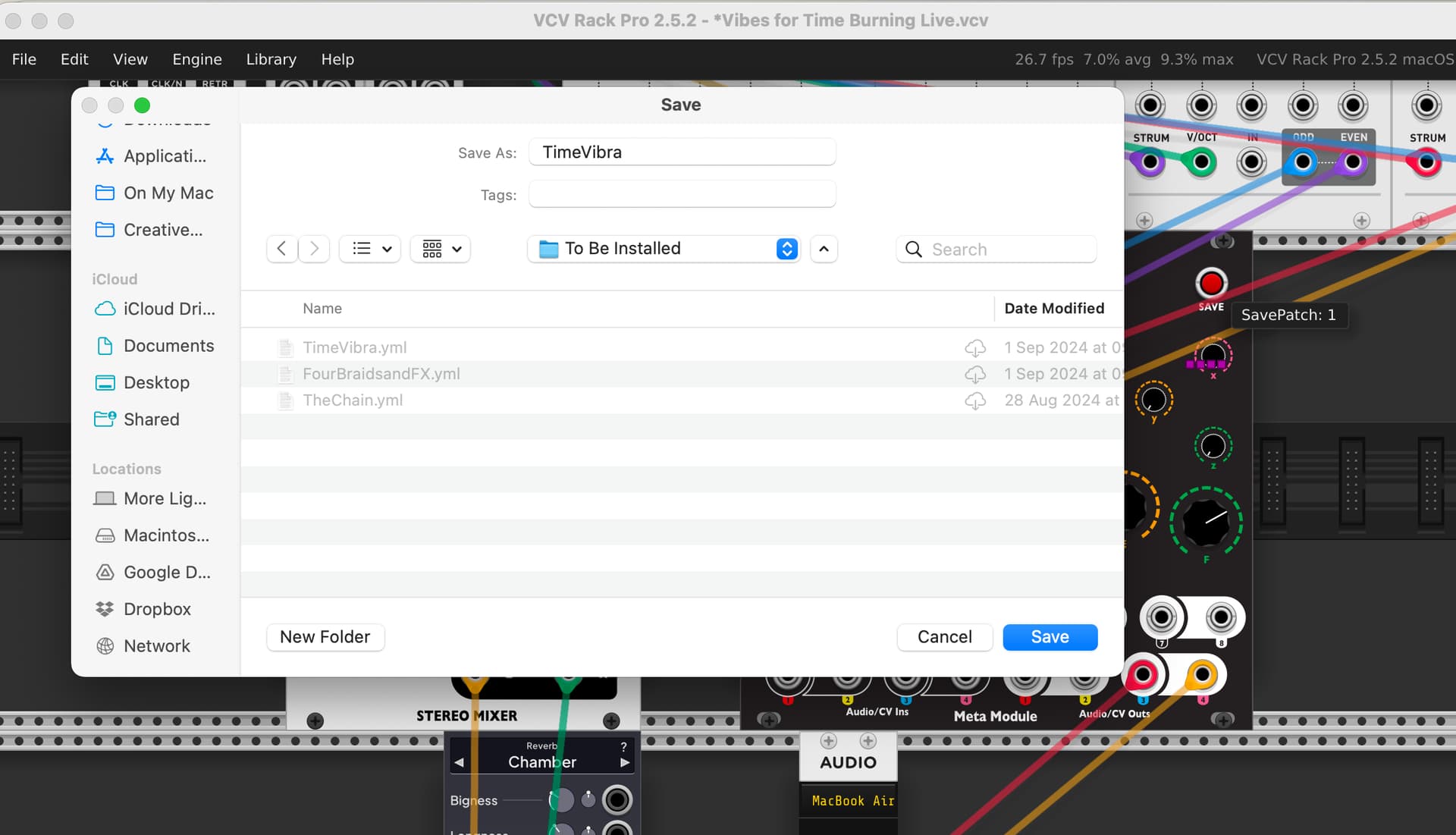

On windows, when i click save (after giving it a name and description) a dialog box pops up and im able to save the file wherever I want.

Works fine on 14.5. Maybe you need to enable something in the settings on your Mac?

I think this is fixed in v2.0.6
I could never reproduce it, but I re-did the save button code and made it more streamlined as to when the Save dialog should pop up.
