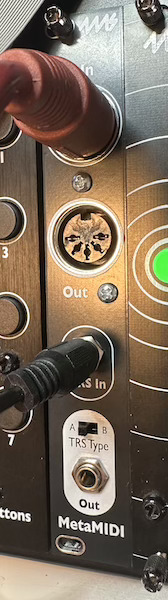

MIDI expander? is there a pic of that - when available?
Probably be out around the end of the year? The first proto worked well.
It’s got a DIN5 input, DIN5 output, and a TRS input and TRS output (with an A/B wiring switch for the TRS output jack – the TRS input jack works with either wiring).
Each of the ports (TRS, DIN5, and USB) is a separate stream, and you can set up filters much like you can filter by MIDI Channel. So for example you can make a patch that receives clock only from the DIN5 Input, and routes notes from USB to one VCO and notes from the TRS input to a different VCO.
All MIDI mappings default to listening to all ports, so the patch will work whether you play into the USB jack or the DIN5 jack. You can also route outputs to any of the three MIDI ports, the default is USB.
This is all working pretty well. I’m adding USB cable support in device mode so that a computer can see the three ports.(edit: decided not to do this – USB traffic stays on the USB port)
