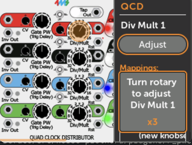

  • Use “snappable” knobs on 4ms modules such as QCD and PEG Div/Mult knob, DLD Time knob, etc.
  • Fix 4ms Drum module (CV jacks and envelope ranges were not working)
Example of Snapped Knobs with the QCD:
