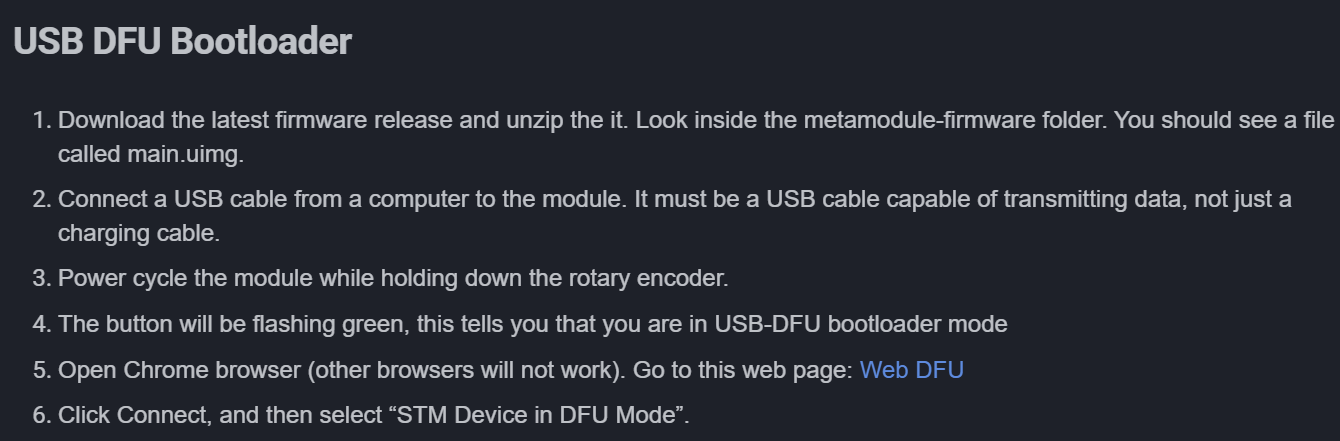

Cycled power now only white screen, please advise.
Attempting Troubleshooting - MetaModule Manual<br>Firmware v2.1.6
Directions show step 6
Which should I pick?
but text does not match.
I am proceeding with SD card restore.
Back to alive on 1.6.4.
Will attempt update to 2.0.10 again.
Success!
Glad you got it. In case anyone else finds this and is wondering the same thing, I updated the docs with more details. In short – you don’t need to click Vendor ID (hex) at all. You just ignore that drop-down and click the Connect button below it.
