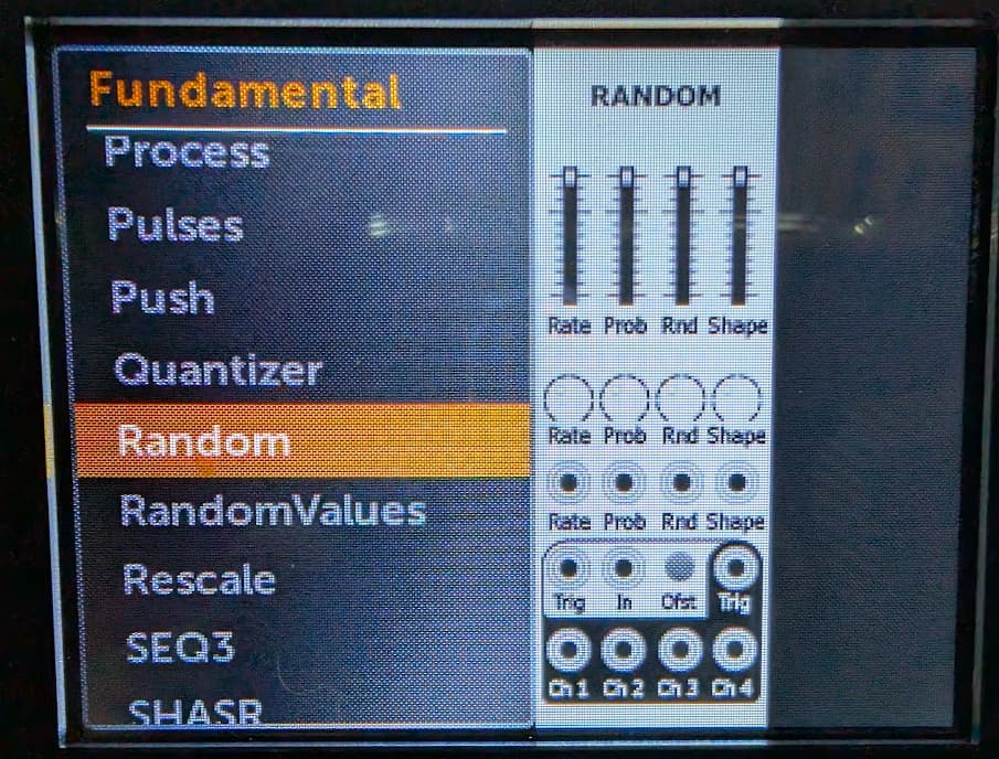

I have installed the latest version. I immediately noticed that a few knobs were missing. At the moment, I’ve only found a few in Fundamentals and CV Funk.
That looks like the assets were not updated. Or maybe the update was aborted while the assets file was being written?
Try updating again, make sure to use the file ending in -firmware-assets.zip

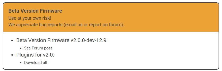

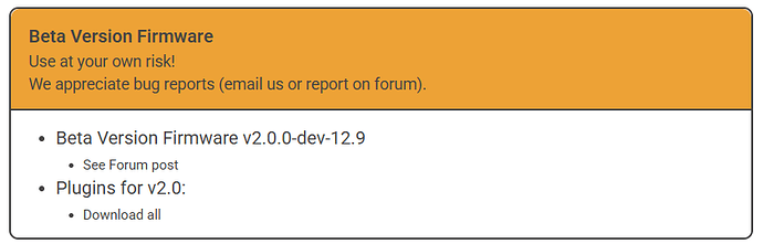

The beta download still shows dev version 12.9. Would it be better to give a date to any kind of firmware uploaded? Same for Plugins for V2.0.
I used the link from above. In the meantime I have made some updates. So I can say that it went through normally, if not quite quickly. But with the same result.

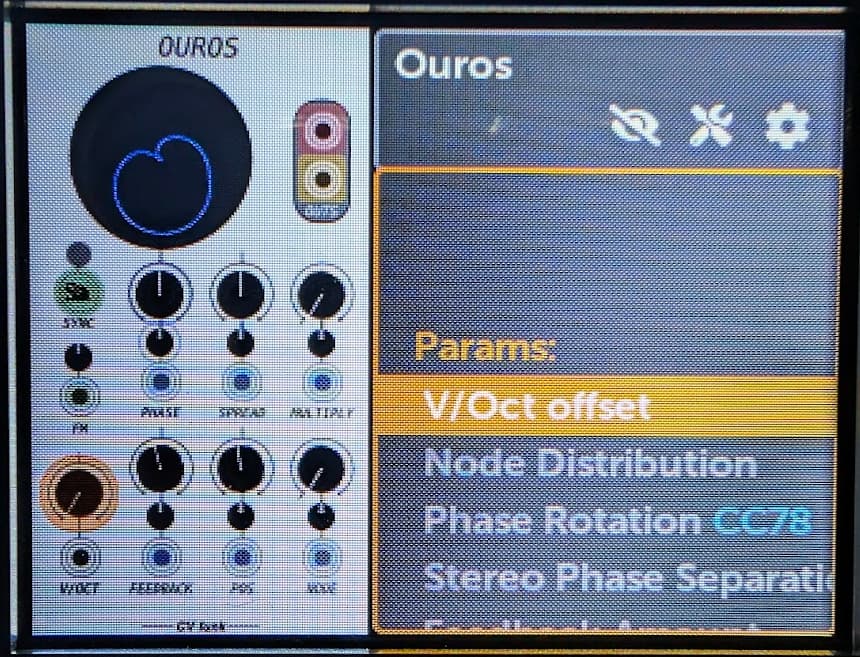

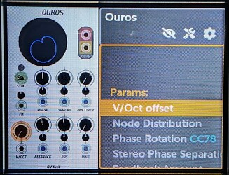

Unfortunately it has even gotten worse. Now a large part of the midi cc assignment is missing. Here is the same picture as before the update. The patch was played, so I can say that everything worked.
I installed the 12.9 afterwards, the “are back” but the midi still missing
What do you mean “the midi are missing”? I see a mapping for CC78 in the photo, are there supposed to be more mappings?

Last picture from the frist post. Two blue circles on each knob, so everything was mapped. In the second pic, there two circles left.

I see, CC77 and another CC are not in the second post. Can you send the patch file?

Thanks. It looks like those mappings are removed from the patch file. The only thing they have in common is that there are other mappings to these knobs in other knobsets. I’m trying to get it to happen again.
I now have 12.14 on it. I still have a lot to do with the patch and there will be a lot more mapping. Maybe I can reproduce it again, then I can let you know.
