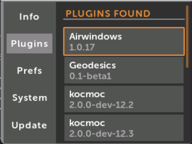

OK that’s a good idea to display multiple versions in a hierarchy.
I did reformat the plugin list so the version gets its own line (no scrolling, unless it’s much longer than the longest versions we’ve seen yet).
Oh yeah, much better. Sorry I missed that, I’m a few versions behind.

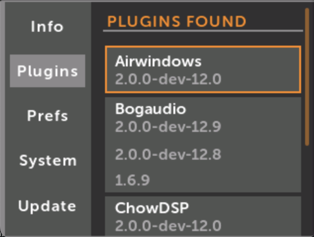

@gabrielroth I started implementing your idea to group the plugin versions:
The plugins are sorted alphabetically, and within each plugin it’s sorted by version newest → oldest.
If you pick a version to load, it will remove all the other versions (which wasn’t the case before).
I’m actually not sure it needs the dropdown arrow (“show all versions”) since the newest is always first. Maybe we could fit take a “LATEST” icon of some sort? Also the dropdown would take up a line, which means we’re only saving space if you have 3 or more versions. I might leave it like this for the release and if after using it, we think it needs a show/hide then we can add that.

Yeah nice, this looks really usable.
