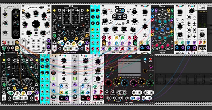

External Audio Routing:
Internal Audio Routing:
-An ensemble oscillator’s outputs are going into two separate Shaped Dual Env VCAs
-Each SHEV is going into a fixed all pass filter
-The all pass filters are fed into a DLD
-The DLD is fed into a Stereo Width module to contain it’s stereo image a bit
-The output of the stereo width module is fed into a plate reverb
-The output of the plate reverb is being compressed by 70s comp
-The entire patch is polished with the 70s EQ
-The feedback loop of the DLD is fed into two pitch shifters, one tuned up an octave, the other tuned up a 5th
-The pitch shifter is fed into a lowpass filter before being sent back to the DLD
Internal CV Routing:
-The opposite channel on each corresponding SHEV is also looping, It’s time is being modulated by the amplitude envelope
-The end of rise output on each shev triggers two channels of Deviant
-The random voltages for deviant are fed back into the shev’s time and shape inputs. This feedback network creates a complex, constantly changing ramp for the amplitude envelope
-The outputs of deviant are sent all over the patch to almost every parameter on every module to create ultimate chaos.
MetaModule Knob Mappings:
A - Ensemble osc pitch
B - Ensemble osc root
C - Ensemble osc spread
D - Ensemble osc balance
E - Ensemble osc cross fm
F - Ensemble osc twist
U - Ensemble osc warp
V - Deviant top
W - Deviant bottom
X - DLD dry/wet
