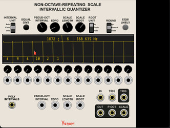

Graphical screens
  • This was partially working dev-6, but now is much more complete.
    • For VCV-ported plugins, the MetaModule calls the rack::Widget::draw(), drawLayer(), and step() functions for all widgets that it doesn’t already know how to draw. Nanovg commands (nvgText, nvgStroke, etc) will be properly rendered (see limits)
    • TTF fonts can be loaded (if you’re developing a plugin, then just put the ttf file in the assets/ dir, and calls to window::LoadFont() will work)
    • Limits:
      • The back-end graphics lib we use (LVGL) has problems with filling convex polygons.
Full-screen button on ModuleView
  • This is just a start of a feature, but it was necessary for me to have this so I could verify if some wide screens were being rendered correctly. I think this will tie into the “performance mode” feature.
