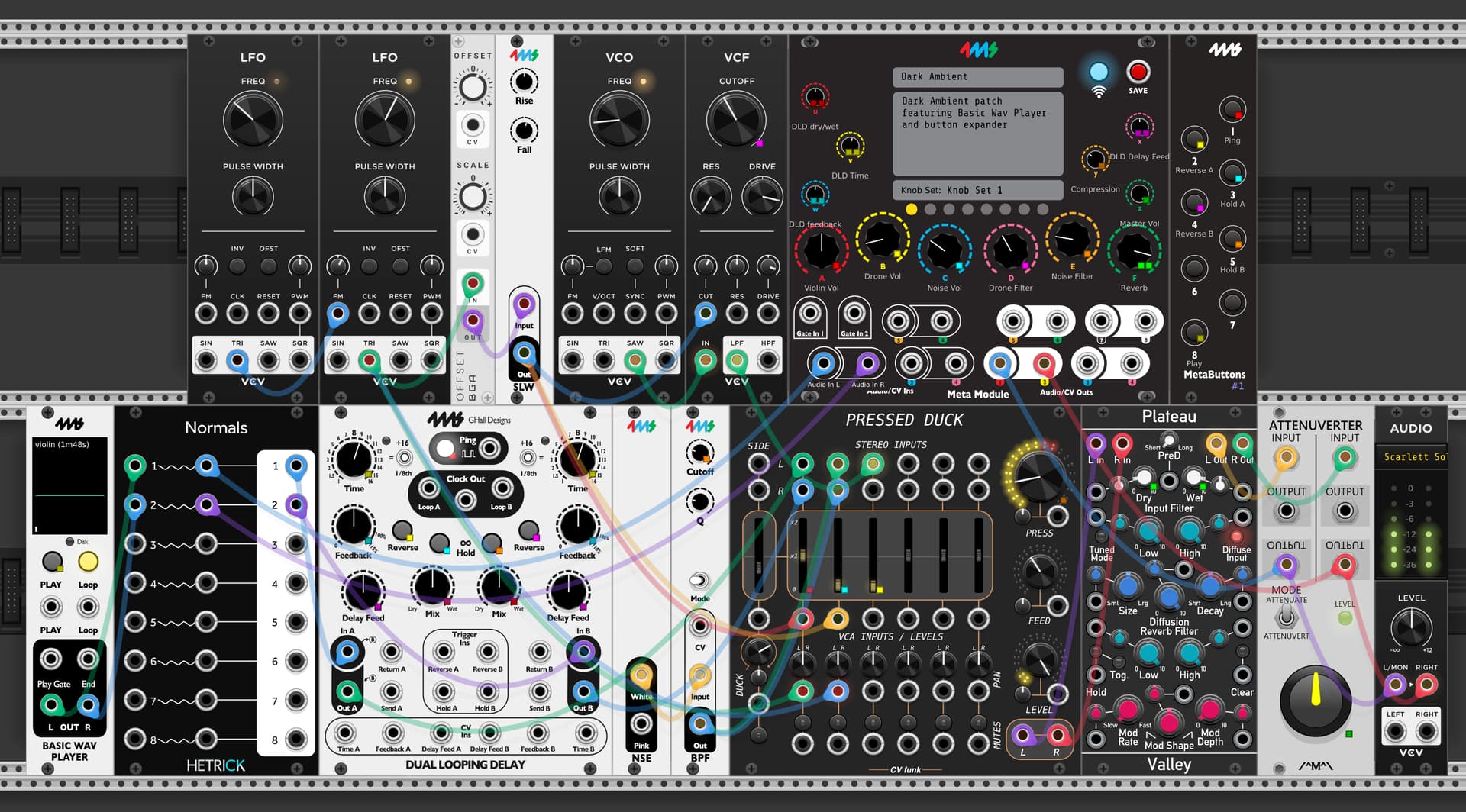

This patch blends an amplitude modulated violin sample with a drone and a filtered noise patch. Gratuitous amounts of delay and reverb make this a great palette for generating dark ambience.
-Main audio inputs on channels 1 and 2
-Main audio inputs run into a Normals for switching with Basic Wav Player
-Basic Wav player runs into a Normals for switching with external audio input
-Output of Normals is fed into DLD and then the main mixer
-A VCO and VCF are combined into a droning synth voice and then sent to the main mixer
-A noise source and bandpass filter are sent to the main mixer
-The mixer is ran into a Valley Plateau reverb
-An attenuator is placed after the Plateau as a master volume control, so that you can drive the Reverb and allow it to distort without clipping your speakers
-A triangle LFO modulates the speed of a second triangle LFO
-The LFO is offset a few volts so that it is a non zero value, and then slew limiting is applied
-The slewed LFO is used as a master modulation source to control the filter cutoff of the drone, volume for the Basic Wav Player/external audio, and panning for all three stems

NOTE You must download the above Violin.wav file and copy it to the same directory as the Dark Ambient.yml file on your SD card or USB drive.
