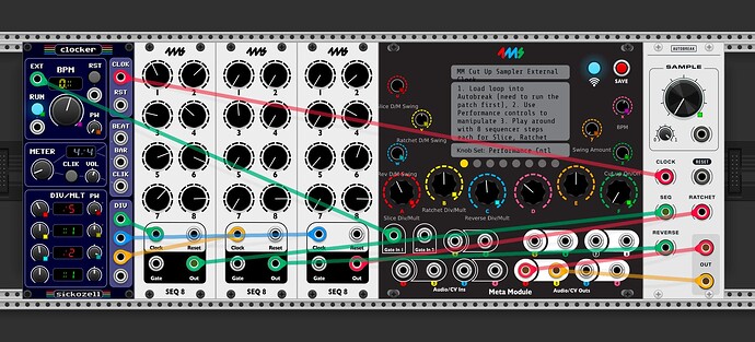

Cut up Sampler Patch
One for cutting up loops - and can run multiple ones which you can switch between live too.
Essentially has three 8 step sequencers, each controlling the following on the VoxGlitch Autobreak.
  • Slice
  • Ratchets
  • Reverse
First set of knobs is performance control - including clock divisions/multipliers to control the sequencers. It can get wild!
Have VCV & MM files here for both internal clock and external clock (via Gate one input) versions.

Enjoy your new cut up sampler :slight_smile:
this is lovely. thanks for posting. You may have sated my desire for an Intellijel Multigrain!
You’re welcome - glad you’re liking it :grinning_face:
This is really cool.
FYI, if you use the new Normals module (in the HetrickCV plugin), you can combine the two versions into a single patch — put a Normals between the internal clock and the sequencers, and connect Gate Input 1 to the middle Normals input, and it’ll connect to the internal clock unless there’s a cable plugged into Gate 1 in which case it’ll look for an external clock there.
Ah cool - didn’t realise that was possible!
