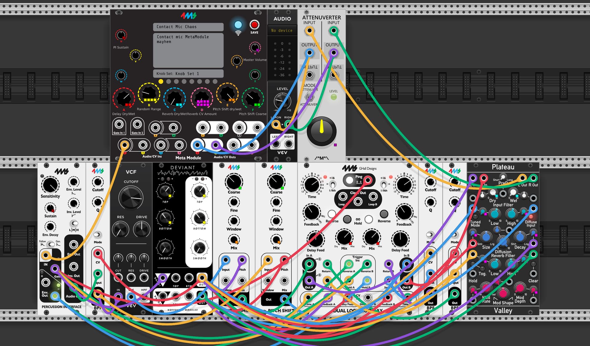

-Main outputs on channels 1 and 2
-Contact mic input on channel 1
-An external contact mic is fed into a percussion interface, for boosting the signal to Euro levels and also generating a master CV control.
-The PI is fed into a bandpass filter and then a lowpass filter.
-The output of the lowpass filter is fed to two pitch shifters
-The pitch shifters are fed into a DLD
-The DLD has two separate bandpass filters in it’s feedback loop, for filtering the delay lines
-The DLD is fed into a reverb
-The reverb is fed into a master attenuator
-A Deviant is being triggered by the gate output of the PI
-The outputs from the Deviant modulate all of the filter cutoffs, all of the parameters on the DLD, all of the parameters on the Reverb, and the pitch CV input for the Pitch Shift.
-The negative and positive gate outputs on the PI control the Reverse and hold functions on the DLD
MetaModule Knob Mapping:
A - Delay dry/wet
B - Random range
C - Reverb dry/wet
D - Reverb CV amount
E - Pitch shift dry/wet
F - Pitch shift coarse pitch
U - PI sustain
X - Master volume
