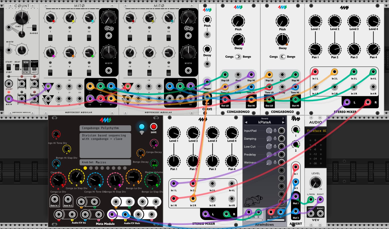

This patch explores our Congabongo and Clave modules—simple and fun Latin percussion sound sources. MITO is generating clock divisions that sequence all of the trigger inputs for the modules. The Slap inputs choke the Tone inputs and also generate their own short envelopes.
  • Main audio outputs on channels 1 and 2.
  • The Congabongos and Clave are mixed together into an Airwindows Plate Reverb.
  • The Count is the main clock source for MITO.
  • MITO’s outputs are fed to each trigger input for the Congabongo and Clave modules.
