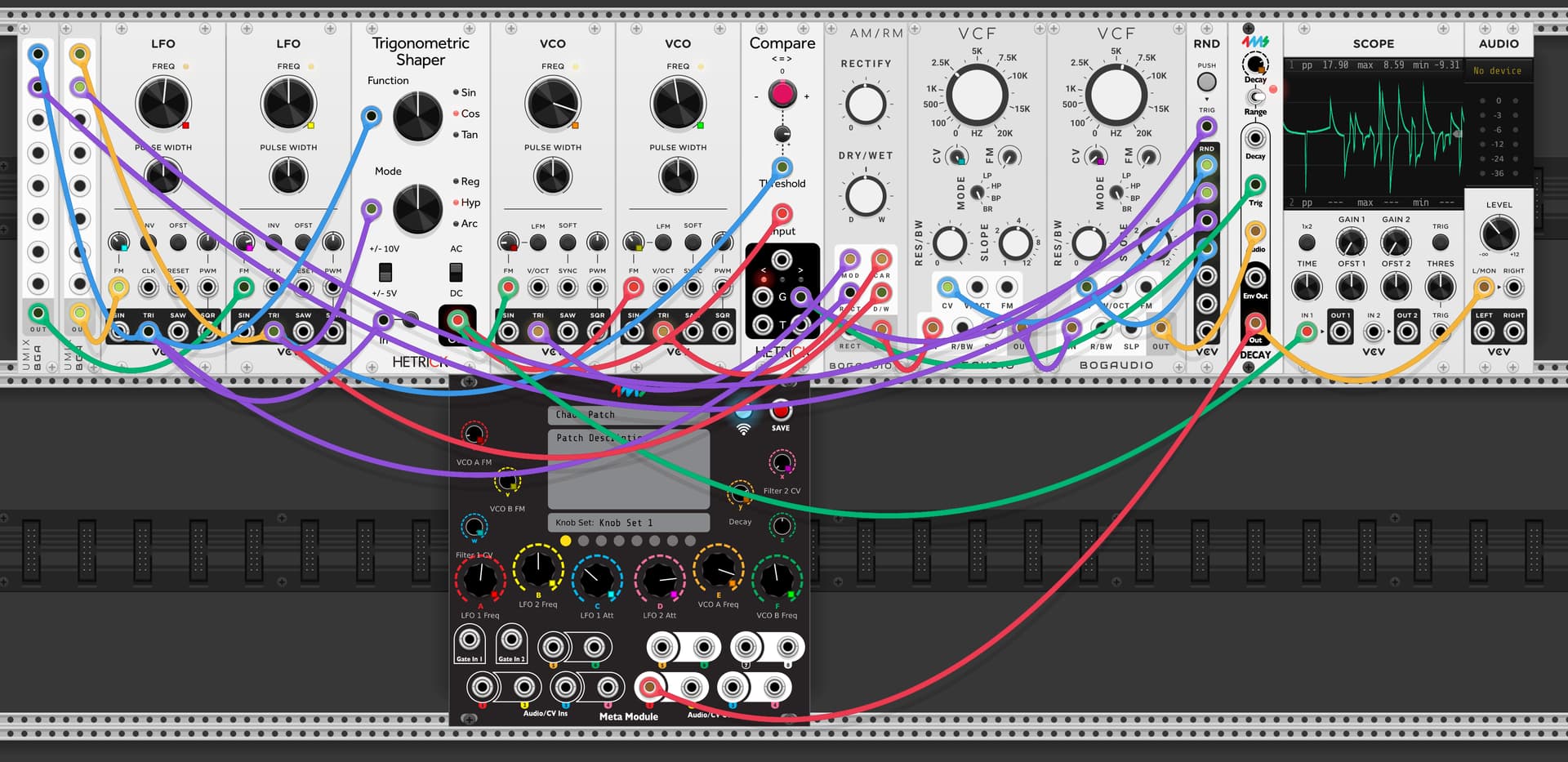

Chaos Patching
You can watch the video for this patch on YouTube here!
-Two triangle wave VCOs are fed into a ring modulator.
-The ring modulator is fed into two serial notch filters
-The notch filters are fed into a single stage decay + VCA
-Two triangle wave LFOs are cross modulated
-LFO 1 is fed into a trigonometric waveshaper
-LFO 1 modulates the function of the waveshaper
-LFO 2 modulates the mode of the waveshaper
-The output of the waveshaper is fed to both VCOs as well as the modulator and carrier CV inputs of the ring modulator
-The waveshaper is also fed into a comparator, whose threshold is modulated by LFO 1
-The gate output of the comparator triggers a random voltage and a single stage decay envelope
-The random voltages are modulating the cutoff of both notch filters
-The random voltages are mixed together with the LFOs before being fed back into themselves
MetaModule Knob Mapping:
A - LFO 1 Frequency
B - LFO 2 Frequency
C - LFO 1 Attenuator
D - LFO 2 Attenuator
E - VCO A Frequency
F - VCO B Frequency
U - VCO A FM Attenuator
V - VCO B FM Attenuator
W - Filter 1 CV
X - Filter 2 CV
Y - Decay
Chaos Patch.vcv (4.1 KB)
Chaos Patch.yml (11.0 KB)
