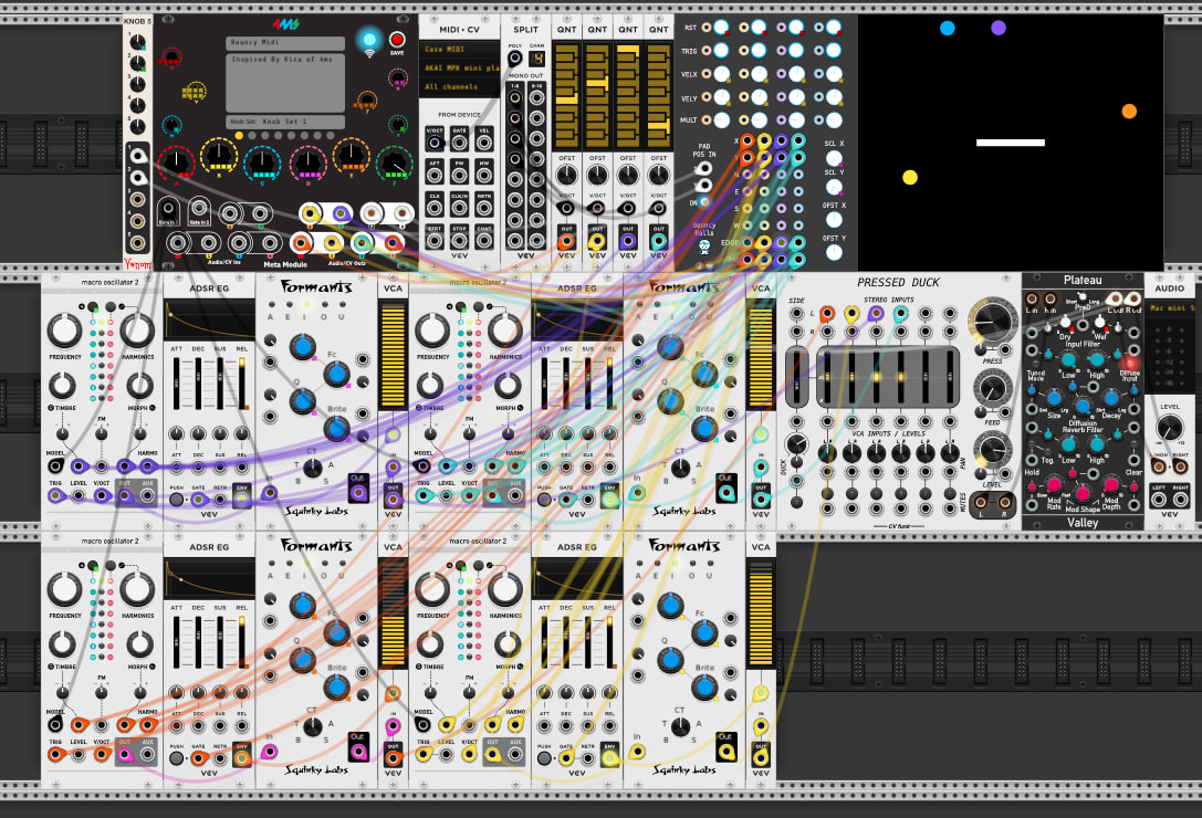

For the show the audience walks around and can experience the music within the orchestra itself, so finding a visual way for people to understand what’s going on with the modular I thought of Kira’s patch with JW’s bouncing balls. I also suspect I’ll need to quantize a bit to vibe with the other parts of the orchestra which has just about any instrument you can think of.
…SO I tried to alter the patch and find a way to lock the scales that so beautifully climbed and descended with the VCA trick they implemented. alas I couldn’t figure out a way to do that. but i DID just use a pretty standard method of locking a quantizer to a solid tone and have each ball trigger it’s VCA. so a bit basic. but i think it’ll work! I just have my midi keyboard on the rotate function of the vcv polyphonic splitter to 4 quantizers so as I mash chords the balls will play in tune… I wish I could figure out a way to control each ball’s note one at a time but that may require two screens or 4 midi keyboards? so for now they’ll just rotate through each 4th keystroke… if anyone has thought’s I’m always appreciative to learn more
I also added some patch in and out points to make the other parts of the modular work with the balls. the knobs are also focused on performance. as I see how the patch practices tonight I’ll probably make some more adjustments.
