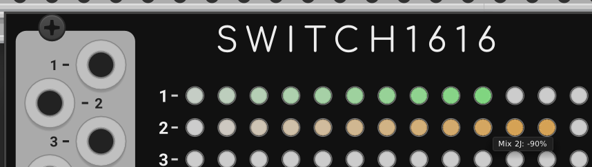

Switch1616 allows the user to enter a % when right clicking in VCV rack, turning it into a 16x16 matrix. right now, it is -1, 0, +1.
is there a way we can mirror that functionality similar to what exists in VCV rack?
Picture attached showing VCV rack’s handling of it.
It’s possible I think by changing the Bogaudio code to consider the buttons as knobs. Likewise I think the other Switch modules are the same (44, 88, 18, 81)

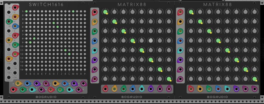

Well… anyway it’s remains a switch matrix. If you want a matrix mixer, there’s plenty of them also by bogaudio.
