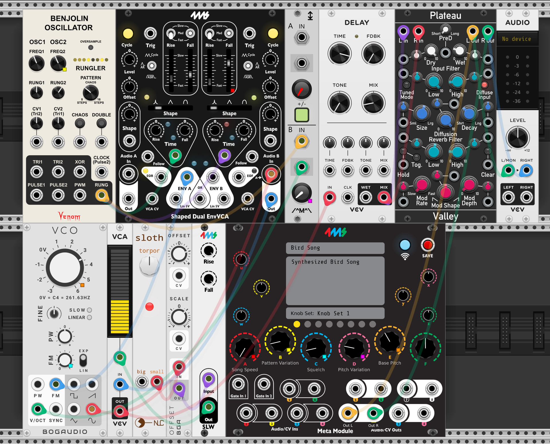

External Audio Routing:
Internal Audio Routing:
-A sine wave VCO is fed into one channel of the SHEV’s VCA
-The output of the SHEV is fed into a secondary VCA
-The output of the VCA is routed to a Delay
-The output of the Delay goes into a reverb
Internal CV Routing:
-The second channel of the SHEV is set to loop to control the amplitude of the oscillator
-The first channel of the SHEV is set to loop, with its envelope output fed into the FM input of the sine wave VCO.
-The Rungler output from the Benjolin is sent to the time CV inputs of both envelopes
-The Rungler output from the Benjolin is also sent to an attenuator before being fed into the sine wave VCO’s 1v/octave input
-A sloth is fed into a 5v offset to shift the signal into positive voltage range only
-The output of the offset sloth is heavily slewed before being sent to the CV input of the VCA responsible for the bird song’s final volume output.
MetaModule Knob Mappings:
A - Song speed
B - Pattern variation
C - Squelch
D - Pitch variation
E - Base pitch
