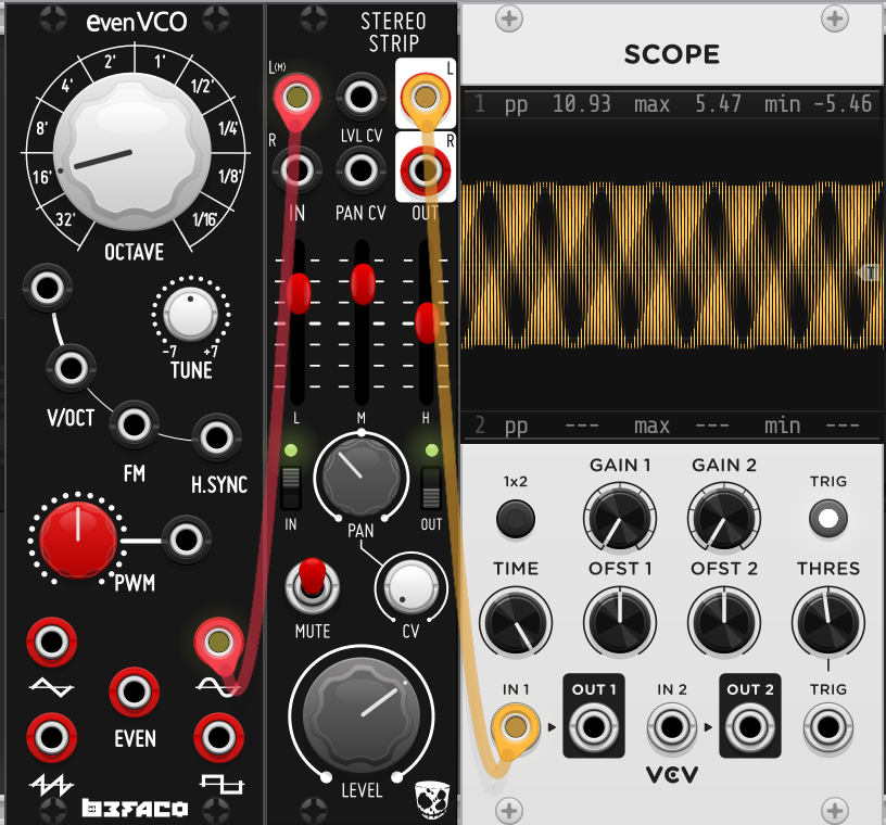

OK, on further tests – the StereoStrip also breaks at 24kHz on Rack. If you switch from 48kHz to 24kHz (using the Engine > Sample rate menu, but not by using sample rate selection on the Audio output module) when a patch is already running then the Stereo Strip outputs some high-freq whining. In this case it doesn’t fade out after a few seconds, but I can sorta hear the expected audio in the background of the whine.
@hemmer have you encountered this?
Can reproduce, and it seems to be the highshelf (at 12kHz, i.e. Nyquist at 24kHz) that is the issue. I guess we can make it a bit lower on the MM version? I suppose I should fix for Rack too (maybe min(0.4 * sampleRate, 12000) Hz for both Rack and MM)? I’ve not come across people using Rack at 24kHz before to be fair!
