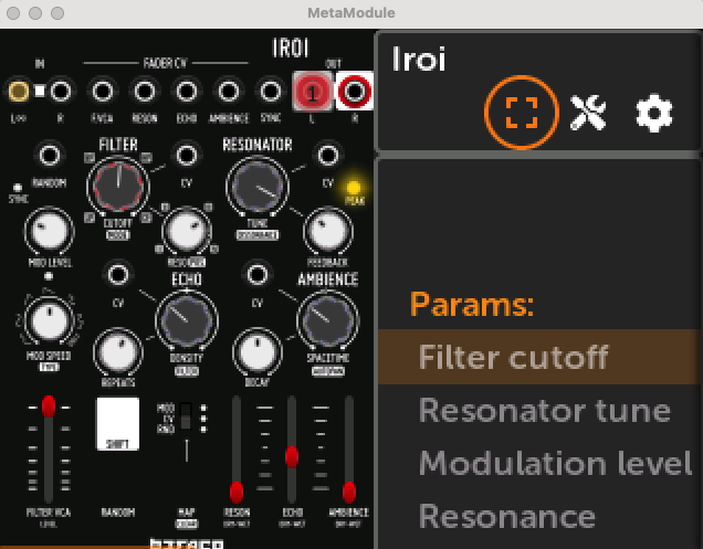

I’ve got it up and running, and it’s making the right sounds, just need to finish the visual side of things, mainly the buttons for random/shift etc. Good news is that this is open source so should be easier to get help if I get stuck. Draft PR here for people who want to compile up themselves: Add Befaco Iroi to metamodule by hemmer · Pull Request #577 · 4ms/metamodule · GitHub
Looking good @hemmer ! Enjoying this in VCV, really good choice of FX that work well together.
Good progress here, alternative knobs are working well but this actually means there’s no need for shift or map buttons (as alternative knobs are drawn over the top of each other). It’ll make sense when I share a build hopefully!
Anyone want to have a little play and let me know of any issues? https://drive.google.com/file/d/1kUk2bD-1ofF-eW4dJpXNnO5oYRg6Z-z7/view?usp=sharing

Such a great module, thank you for your work on it! I tried to download it from here but looks like the link is pointing to the MM firmware and not the Iroi module, am I missing something? :slight_smile:
@dada.sandor - The Iroi module is part of the ‘built in’ modules and is part of the firmware on this thread. So you have to update to the firmware above and then you should be able to see the Iroi module.
Oh I see! I’ll give it a try this way, thank you!
I guess this will be part of the Befaco modules once it’s released
Thanks to @anDREW for pointing out the sample rate issue, latest firmware (including updated builtin Befaco) can be found here: https://drive.google.com/file/d/1oDjEvY27wJSro8AKUOI5-u_bKHG4dBhT/view?usp=sharing

I found the module rather deep when it came to mapping - so many hidden parameters its easy to run out of knobs to map to and also very easy for me to lose track of where I’m at. So I made a template for Rotocontrol which ended up making my life a lot easier. As Rotocontrol can send 14 bit CC values and the MM can receive them there’s no real downside to using midi vs CV. A quick proof of concept…

I just tried IROI plugin and found like a bug
When I turn full CCW the “mod speed” knob it seem to stays at full speed even if i turn back CCW (doesn’t respond anymore)
then “level mod” knob is no more relevant as it goes really fast in full amplitude even though the knob position is @ 8’
The behavior ends in an ocean of harsh noise.
Anyone haveing this behavior?
I’m on FW 2.3.1
