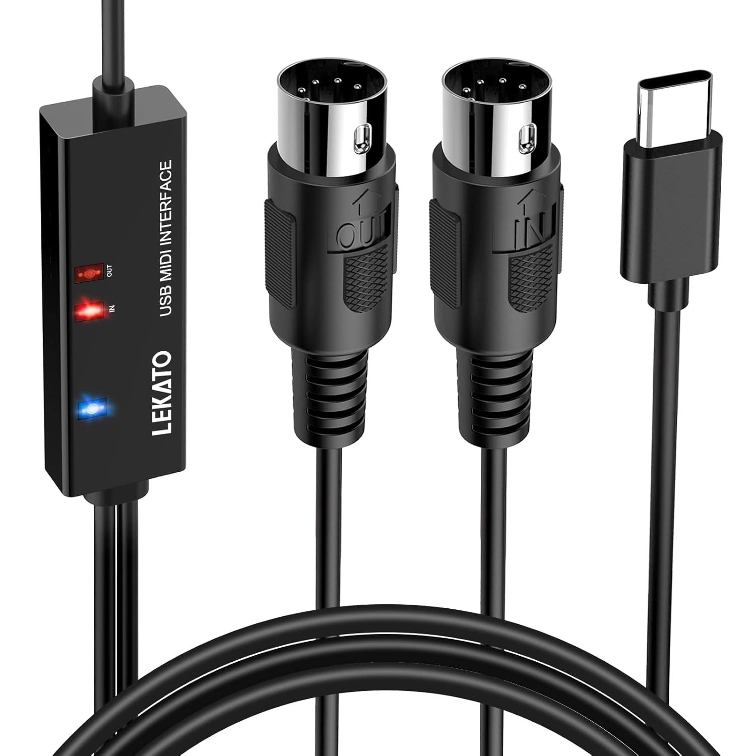

i don’t own an op-xy but my guess is the xy acts as a midi host, and so does the mm which would cause conflict. so you might need to create a usb to din bridge using a trs to midi din cable (type A for op-xy i think?) then connect that to a usb to din adapter, that would be connected to the mm.
i use this class compliant usb/din adapter and it has worked well with getting mm to ‘talk’ to my laptop, ipad, etc. and vice versa.

That would make sense. I’ll try to use the 3.5mm MIDI output on the OP-XY instead of the USB output and report back. I’ll check out those adapters, thanks!
Just following up. The adapter you sent worked :+1:. But I started running into some new issues with 4 MIDIToCVInterfaces (3 gates + 1 CV), where one gate just doesn’t get sent to the panel output, even though the interface plugin in the meta module is receiving the MIDI data (I can see the note on/off triggers in the plugin “screen”). Will investigate more and maybe open a new thread for this later on.
