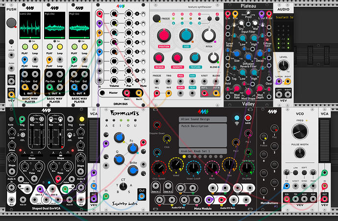

Alien Sound Design Patch
You can watch the video for this patch on YouTube here.
NOTE For this patch to work, the following files need to be in the same root directory as your patch:
External Audio Routing:
-Main Audio outputs on channels 1 and 2
Internal Audio Routing:
-The output of 3 Basic Wave Players are fed into a Drum Bus
-The EOF output of the shaped dual envelope VCA are fed into a Formant filter
-The output of the formant filter goes into a VCA
-The VCA is mixed into the Drum Bus
-A sine wave VCO is fed into a VCA and mixed into the Drum Bus
-The output of the Drum Bus is fed into an Audible Instruments Texture Synthesizer
-The output of the Texture Synthesizer is fed into a plate reverb
Internal CV Routing:
-A push button triggers the play button on all 3 Basic Wav Players, as well as one channel of the Shaped Dual Envelope VCA
-The envelope output of channel one of the SHEV is fed into the time input of channel 2 to make the looping envelope faster and slower.
-That same modulation envelope changes the vowel and cutoff on the formant filter, as well as the FM on the sine wave VCO.
MetaModule Knob Mapping:
A - Click speed
B - Vowel
C - Vowel Cutoff
D - Pitch
E - Size
F - Dry/Wet
U - Doppler down volume
V - Click volume
W - Lion roar volume
X - Pig squeal 1 volume
Y - Pig squeal 2 volume
Z - Reverb decay
MetaModule Button Mapping:
1 - Main pushbutton
2 - Freeze
