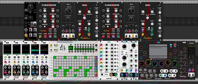

Acid Patching
You can watch the video for this patch here.
NOTE FOR THIS PATCH TO RUN ON METAMODULE YOU MUST DOWNLOAD THE FOLLOWING AUDIO FILES AND PLACE THEM IN THE SAME DIRECTORY AS THE PATCH ON YOUR SD CARD
External Audio Routing:
Internal Audio Routing:
-5 Basic Wav Players are loaded with 606 drum samples and ran into the Drum Bus for mixing
-Two voices consisting of a sawtooth wave VCO and Autinn Bass and also mixed into the drum bus
-The drum bus is running into the 70s Comp and 70s EQ for pseudo mastering control
Internal Logic Routing:
-A main clock generated by Count is clocking both Fluencerators and a Drum Sequencer
-The gate outputs of the drum sequencer trigger each Basic Wav Player
-The gate outputs of the Fluencerators connect to the gate inputs of the Bass modules
-The accent outputs from the Fluencerators connect to the accent inputs of the Bass modules
Internal CV Routing:
-1v per octave signals from the Fluencerators go into the sawtooth WAV VCOs
MetaModule Knob Mapping:
Knob Set 1: Sequencer + Synths
A- Voice 1 filter cutoff
B- Voice 1 resonance
C- Voice 1 decay time
D- Voice 1 envelope depth
E- Voice 2 filter cutoff
F- Voice 2 resonance
U- Voice 2 decay time
V- Voice 2 envelope depth
W- Fluencerator Phrase length
X- Fluencerator Rest
Y- Fluencerator Accents
Z- Fluencerator Glides
Knob Set 2: Mixer
A - Kick Volume
B - Snare Volume
C - Closed Hat volume
D - Open Hat Volume
E - Cymbal Volume
F - 303 Bass Volume
U - 303 Melody Volume
MetaModule Button Mapping:
1- Kick mute
2- Snare mute
3- Closed hat mute
4- Open hat mute
5- Cymbal mute
6- 303 Bass mute
7- 303 Melody mute
8- Generate new pattern
