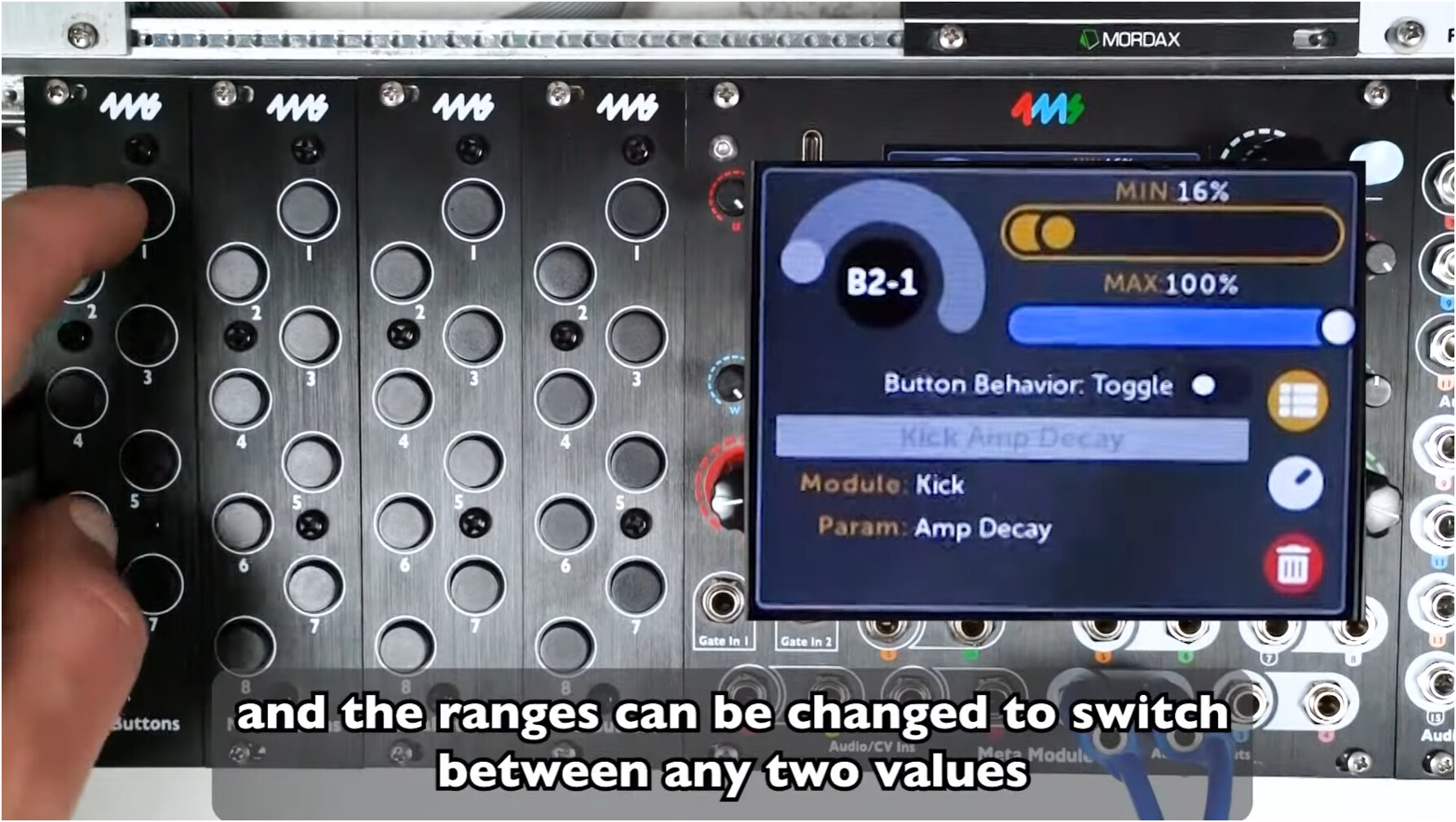

Just wanted to find out if I could map the eight buttons to play like a keyboard, setting the range of value to match the OSC. Maybe I’m asking the wrong question :grinning_face_with_smiling_eyes:

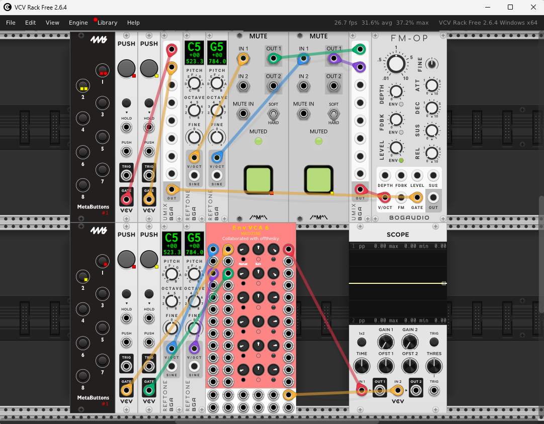

you might be able to build it with either of these setups:
Thanks. Question was based on the built in range of value settings in MM.
ah i think i just read your ‘eight buttons to play like a keyboard’ part, which i was actually attempting to get working via a midi controller of trigger pads, for a project. but afaik, there’s no way to set the ranges to notes instead of percentages (if im now understanding you correctly)
