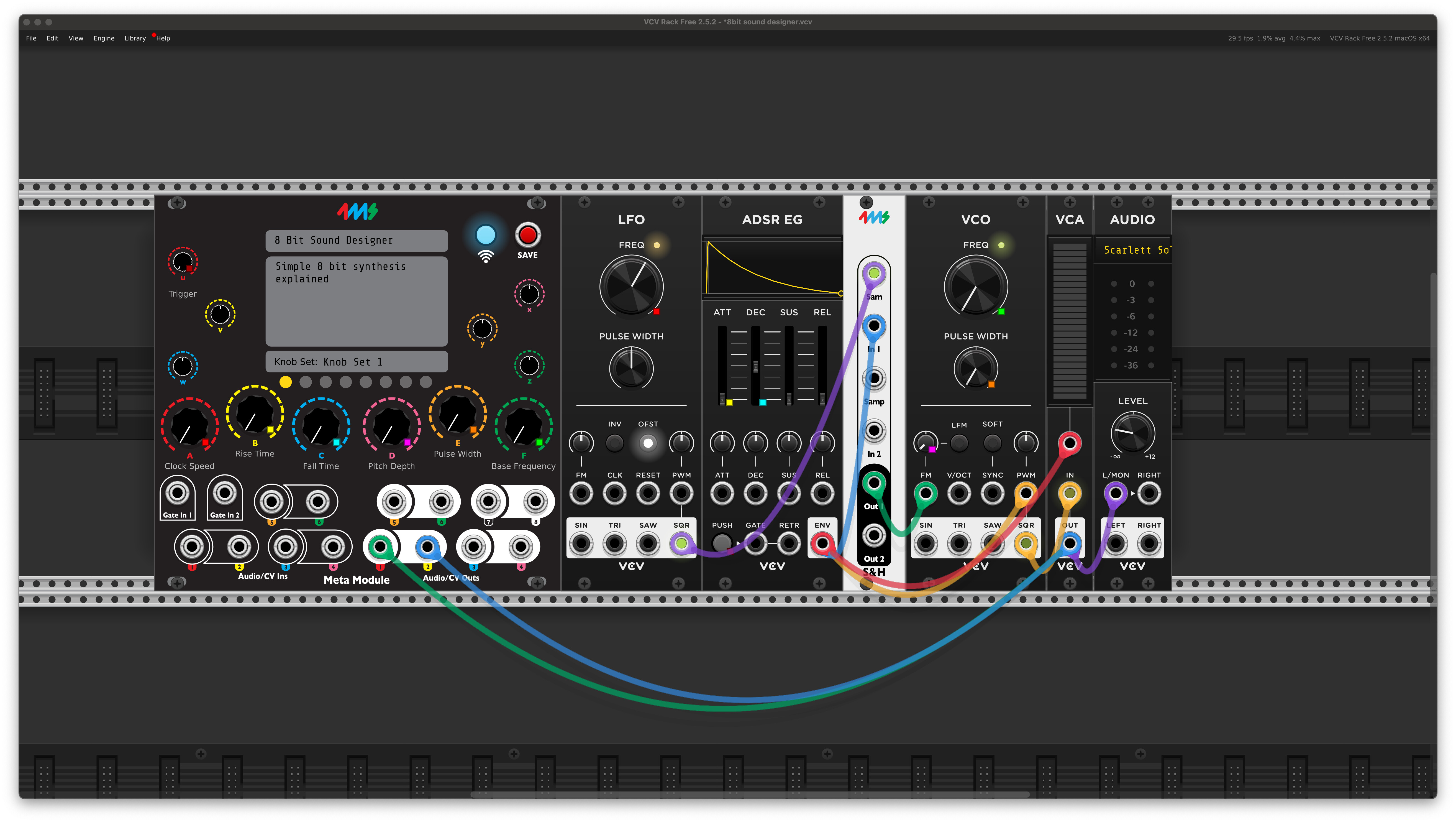

8 Bit Sound Design
Watch 8 Bit Sound Design on YouTube
-Main Audio outputs on channels 1 and 2
-A pulse oscillator’s volume is modulated by a VCA then sent to the main outputs
-A ramp generator is sampled and held
-The clock for the sample and hold is controlled by a square wave LFO
-The output of the S&H controls the pitch of the pulse oscillator
Metamodule Knob Mapping:
A - S&H Clock speed
B - Ramp rise time
C - Ramp fall time
D - Pitch modulation depth
E - Main oscillator pulse width
F - Main oscillator base frequency
U - Ramp trigger

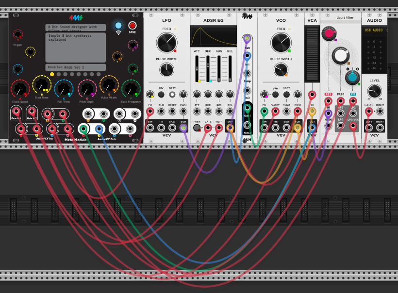

so smart, so fun! sadly, I already packed up my stuff for knobcon! :smiling_face_with_tear: can’t wait to try this one out though, I am saving it to a flashdrive with a filter and inputs mapped, so it’s ready to go when I unpack!
