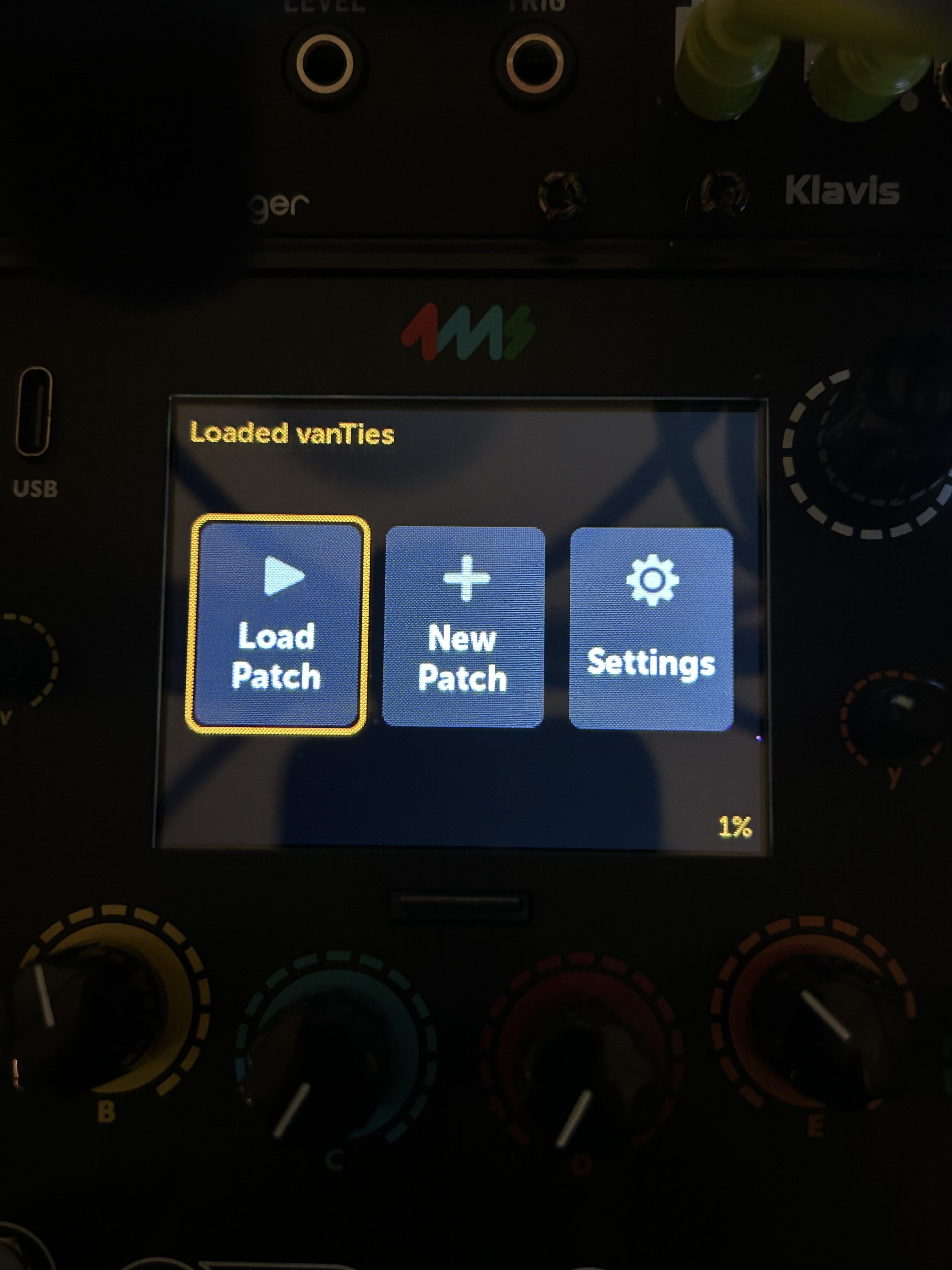

As you can see on the screen the MM freezes while pre-loading (always freezes when the “loaded vanTies” appears.
Multiple power cycles didn’t fix it.

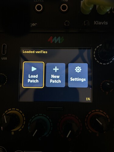

Never mind. It was a patch that I loaded before (and that tried to load every time I started the MM)
The issue lies within that patch or to be precise: it’s the Sickozell Drumplayer xtra or the samples that I try to load with the patch that crashes MM.
I try to load short one shot samples (kick, hihat etc)
But even when I start a new patch on the MM only with the Sickozell Drumplayer Xtra and load the samples through the options menu, it freezes completely.
