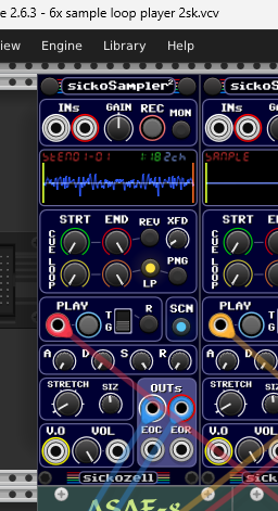

also @sickozell - im noticing an issue where with sickosampler2 in vcv the full sample will load, but in mm it seems only part pf the sample will load. is this a known issue or am i just doing something wrong with ss2 in mm?
vcv reads 1:18

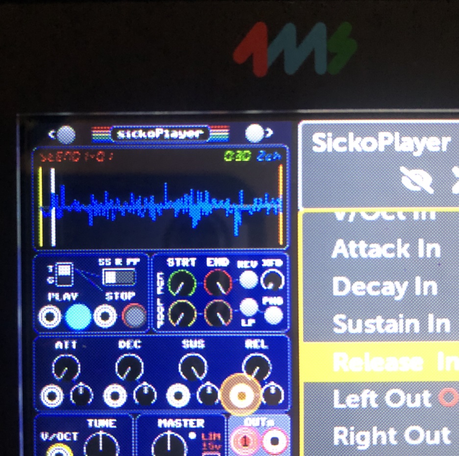

exact same sample loaded in mm read only 30s and on playback, definitely not hearing all the sample:
also seems to occur with the sickoPlayer
on latest firmware v2 dev 13.4 (latest plugins from bundle in thedownload)
maybe it’s something with that wav file that drwav library can’t read. How long should be that file? Which samplerate? How many channels has it?
[Edit: Maybe MM ran out of memory? What happens if you build a patch with only that sample?]
its just a stereo PCM signed 48kh/16bit wav file. it’s 1:18 long m, 14.4mb on disc. my patch was made from scratch on the mm: 1 instance of sicksampler2 routed to outs 1/2. ram showing 83/278 after the wav is loaded.
i also just tried w a different wav that is 33 seconds long and the ss2 only shows 30s. it seems anything over 30s is getting cut down to 30.
i can send you these wav files if you need them
Maybe it is memory allocation limit in MM? @danngreen should be able to provide info.
yes, that’s the memory allocation limit we agreed with @danngreen : it’s about 30 seconds stereo @48khz and about 1 minute mono.
ah ok 30s is the hard limit
